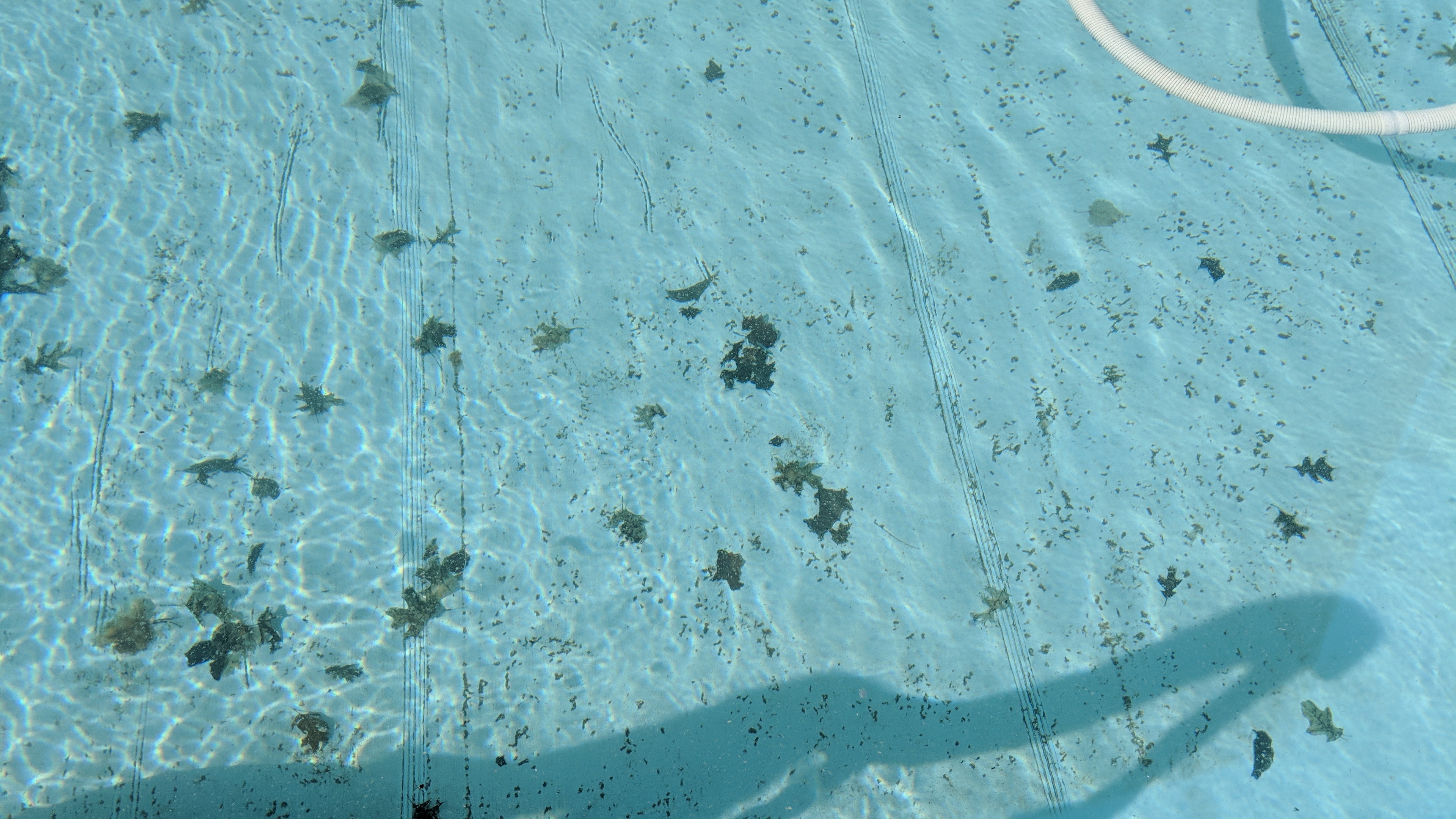

I have not covered my pool in the 8 years I have had it.. I do not have trees around my property.. You may get some leaves but the trees seem to be far away.. I would do a couple things..
1. when the temp of the water gets below 60 degrees take you FC to SLAM level.
2. pull your equipment, put it in the garage and call it a day...
3. on a nice 60 degree day in Jan, mix your water with a brush, test your FC and take it back to SLAM level and brush it again to mix everything...
4. Open the pool before the water hits 60 degrees..
This is what mine looks like in spring doing exactly those directions.. This is from multiple years, 1 year I had more leaves.. :)
That is what I closed my pool with.. I used a shopvac to blow air through the pipes, works great when not lowering the water :)
