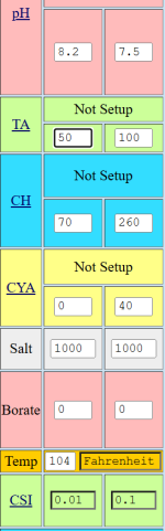

At a TDS of 1,000 ppm and a temp of 104, the Calcium Hardness should be 80 to prevent scaling.
You can manage the pH at 7.9 to 8.3 if you have a pH meter.
Keep the CSI between about -0.3 and 0.0.
