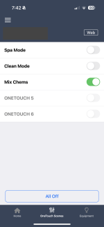

I usually make my muriatic acid additions in the morning between 7-8AM, and at this time the pump is still running slow (1750 RPM) as per above schedule, so when I add the acid by slowly pouring in front of a return jet, I like to temporarily kick up the pump speed to 2400 RPM for 15 minutes to help disperse the acid. Using the iAquaLink mobile app with my iQPUMP01 controller, there is a "custom speed" option which makes this possible:
Selecting this function runs the pump at 2400 RPM for 15 minutes and then automatically returns to the normal schedule.
How do I do this in the full Aqualink RS system? I'm assuming there must be a way, something like "Quick Clean" button found on pumps, but for shorter time periods (15-30 minutes). It doesn't need to be infinitely adjustable like the option I show above, if I could set an "on-demand" routine (2400 RPM for 15 minutes) and assign that to a button in the App, that would be OK too.
