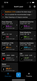

Hi, I started using the Taylor test kits and this site exclusively in March 2024, and it’s been going great! I have this weird issue lately where all my chemicals seem consistently fine, but maybe every 1-2 weeks, I get like 5-7 little dime-sized dots of like green algae on the bottom. I’m attaching a picture to show you. They brush off pretty easily, but I keep getting more. Not a lot, but some.
My chlorine levels stay around 7-8ppm, and I keep all my chemicals in range and test regularly…they don’t seem to spread, but I wonder what they are and how I stop it.
Maybe a month ago my chlorine got real low and we had family about to come stay with us, so I didn’t want to slam it fully, but I did like a mini slam, where I got the levels up at like 12-14 for a few days, until my combined chlorine got back to normal (it was at 1.0 for a while and then back to <= 0.5 and chlorine stabilized again.
I did slam it fully probably 4-5 months ago.
Any ideas??
