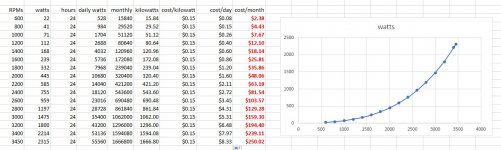

Just make sure the pump is on the "approved" list for a rebate. Also see if they require "professional" installation. The $300/year is strictly energy savings, which, depending how you run your new VSP pump, could be a lot more than $300. See my chart below.
