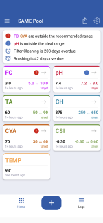

Uh oh. Did you forget that Leslie’s isn’t good at testing and that you should never listen to any of their advice? 😉 What does your TF-100 test kit say the water test results are?
Yep, I don't ever go to Leslie's but went there to get the water tested for metals.
I posted the image with the test results above. It seems like the TA was fine on my results but can that be incorrect?
The TF-100 is correct, the Leslie’s test is incorrect. They use some kind of adjusted alkalinity which always makes you buy expensive baking soda. Ignore all their tests.
Okay, my pool builder may have figured it out for me. Right off the bat he said it could be mulch running into the pool.
In the last 2 days, we've had some heavy rains in our area. The issue started 2 days ago when the water looked a bit black and then last night we had thunderstorms with heavy rains again. This morning the pool water looked even more black.
Guess what's new since last week? We mulched our landscaping last week with ultra fine BLACK mulch. My PB thinks the black mulch or the rain water with the mulch dye could be running into the pool from the deep end.
Since all my chemicals looked fine, this is a very possible diagnosis. I'll most likely have to drain the pool and probably good idea since my CYA is higher than ideal.

Based on the threads James posted earlier, no immediate action required right now, correct? This will clear up in a few days after rain stops
He said Total Alkalinity (TA) was very low and he hasn't seen it that low in a long time.
It only appears to be low because they are reporting corrected alkalinity which is only the carbonate alkalinity part of alkalinity. It's a disgrace that they still call this "Total" Alkalinity. CYA's contribution to alkalinity is real alkalinity.
The only reason to subtract it from total alkalinity is to use the resulting carbonate alkalinity to calculate the amount of carbonate in the water for saturation index calculation purposes. This should be fine internally by their software.
Calling this still "Total" Alkalinity is just a scare tactics to sell more overpriced baking soda to their customers. They are basically hooking customers into a subscription scheme. Reporting TA lower than it actually is, means that the pool is way overcarbonated, resulting in more CO2 outgassing, driving pH up. This will be fought by adding acid, driving TA down again. Add baking soda and start again.

Well, they got me. I bought 20 lbs (two 10 lb buckets) of "baking soda" from them prior to realizing it was the mulch dye and used 10 lbs initially. Once I realized it wasn't my TA and just the mulch, I returned the other tub.
Thanks for the input.
Reactions: mgtfp and JamesW
As long as you are chlorinating with liquid chlorine or an SWG, you can let TA (the real thing, no corrections) drop down to 50. If it gets lower you should add some baking soda to bring it back up a bit.
When chlorinating with Trichlor, then slightly higher TA is advised because Trichlor reduces pH and TA. CO2 outgassing is then desirable to compensate Trichlor's acidity, and TA will need regular top-ups. But since Trichlor use needs to be limited anyway due to CYA build-up, this shouldn't be a concern anyway when applying TFPC.
