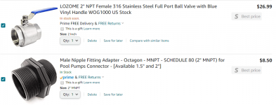

On a side note, I am surprised that there is no shut-off valve for the connection between the skimmer hoses and the pump itself. I am also looking to find a suitable valve and fittings to make this happen. The reason there should be a shut-off valve is so you can clean out the the pump filter w/o water gushing all over. The only other solution I found is to plug the tubes at the pool. This of course works, just isn't as nice of a solution as having a proper shut-off valve. Most suitable solution I've found costs about $30 for this setup. Yes, there are some cheaper PVC ball valves but I've found they don't operate all that smoothly at a 2" size.

For the connection between the vacuum lines and the filter I swapped the Bestway 1.5" to 2" tee connector for the Intex split hose plunger valve. Amazon no longer seems to carry it. But it works well for the job of shutting off the intakes simply and easily.
