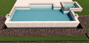

I was thinking the pool side of the weir wall will be lower than the outer edge, so the pool looks larger. The weir wall is ~14" thick and the pool juts out, so this gains 14" in aesthetics for both depth and width. I've made renders, here's a bird's eye view:

It's not too late to change, but I'm torn. Cons: it makes the pool look smaller. Pros: the top of the wall can be tile and the visual transition from pool wall to background is very clean.
Does a lower outer edge reduce splashing into the lower basin? I'm looking for more pros to convince myself. :D
How much lower (or what angle) should the outer edge of the wall be?

I would slope away from the pool.
It's too late now, but you could have just made the pool bigger if you wanted a bigger pool.
You can use a blue tile that matches the water color so that the tile is mostly not visible.
The water level in the pool should always be at the top of the wall, so the plaster can go all of the way up.
You can do a bullnose tile to wrap around the top or you can put a 2” band below the lip to give an edge.
