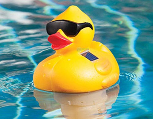

Right now for example we had to drain 1/3 of the pool for some work AND we have had a bunch of rain so my Salt is too low for the SWG and Im sure the CYA is low as well, and it wont be fixed till Monday. So Ive thrown a couple pucks in this cool solar lighted duck .. Im pretty sure I paid closer to $10 at walmart
https://www.amazon.com/GAME-8002-Solar-Light-Chlorinator/dp/B007MPVT2O
I like him so much I may put a rock in him to keep him upright when Im done with the pucks
be sure to get the new Version with the panels on the side
OK, that is just neat....
Had to order one!
Had to order one!
Yeah
Here is an image of him lit up at night
He holds like 6 pucks if you really used pucks a lot
He is supposed to tip over when empty, which is why I said I would add a rock to keep him upright ...
And the LED is impressive for the tiny little Solar panels
Once I noticed he was still glowing at 5 am
