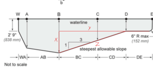

I think I read somewhere in this 2018 INTERNATIONAL SWIMMING POOL AND SPA CODE (ISPSC) | ICC DIGITAL CODES that an actual spring board needs a minimum depth of 12'.
You can make the whole thing 10' deep.
If B is 10’ and D is 3.5”, then X is 6.5’.
Y = 3X (Minimum).
If X is 6.5 feet, then Y has to be 19.5 feet.
The diving envelope has to be big enough as described in the below reference for the diving board type you want to use.
American National Standard for Residential Inground Swimming Pools ANSI/APSP/ICC-5 2011
PERTAINING TO APPROPRIATE POOL TYPES FOR DIVING EQUIPMENT
Your slope will still be too steep.
Your numbers do not work.
Assuming AB is at least 8’, the slope works out? Another solution to ease the slope would be to make the shallow end a tad deeper or the deep end a tad shallower. My deep end is 9.5’, maybe 9’ measuring from the waterline.
WA + AB + BD + DE = Total Length.
If WA is 2' and AB is 8' and BD is 19.5' and DE is 8', then the total length is 37.5'
I would recommend a 20 x 40 pool if you really want a 10' deep pool.
1692233986934-png.522940
WA on my pool is zero (or maybe a couple inches for a radius) so he could technically get it if they make that wall vertical. But yea it’s tight.
