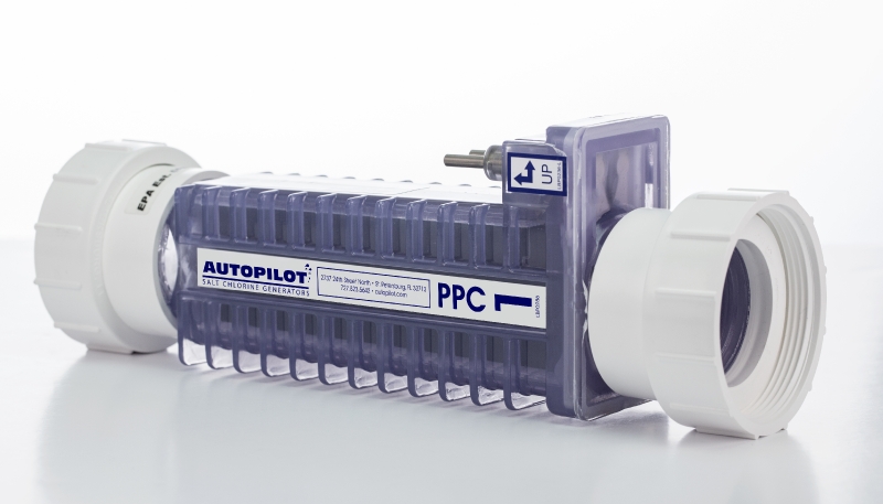

My pool is about 22k gallons and I was checking the specs of the AutoPilot cells.
I saw that the smaller PPC1 cell is rated at:
Pool Size Up to 40,000 gallons/151 m³ with the Digital
So that's probably good for my pool and that's also why the previous bigger cell lasted for 10 years :)
I think that if I can find it for say 600/700 EUR I can have it a try and keep the DIG-220 for some other years.
What you think?
I saw a couple on eBay.It for around that price, or at least the RC-42 cell
My understanding of the Autopilot cells is...
The AutoPilot cells are:
  • PPC1 - 28,000 gallons
  • PPC2 - 32,000 gallons
  • PPC3 - 50,000 gallons
  • PPC4 - 60,000 gallons
  • PPC5 - 80,000 gallons
A 28,000 gallon cell would be too small for your 22K pool.
We recommend a cell be at least 2X the pool volume.
I think you need at least a PPC3 cell.
The Salt & Swim 3C can chlorinate an in-ground pool up to 30,000 gallons. That is not big enough for your pool. You need a system speced at least 40K.
I see here it says - The PPC1 is sufficient for up to 28,000 Gallons with the Digital Nano; Up to 40,000 gallons with the Digital, 75003 or Soft Touch.
Yes, so I assume with my DIG-220 it should be up to 40,000 gallons. Am I right?
Still not easy to find in Europe but I can try.
Nobody ships to Europe from US.
That is what I gather from what I have read.
If you can make a call to the US call the saltpoolguys. They are very knowledgeable on the Autopilot system and should be helpful even if you cannot buy from them.
I guy from saltpoolguys was so kind to reply:
"With the older versions of the controller, the PPC1 cell is only good for up to 35-36k gallons.
The PPC1 would be plenty large enough for your pool."
Now I just need to find one...
