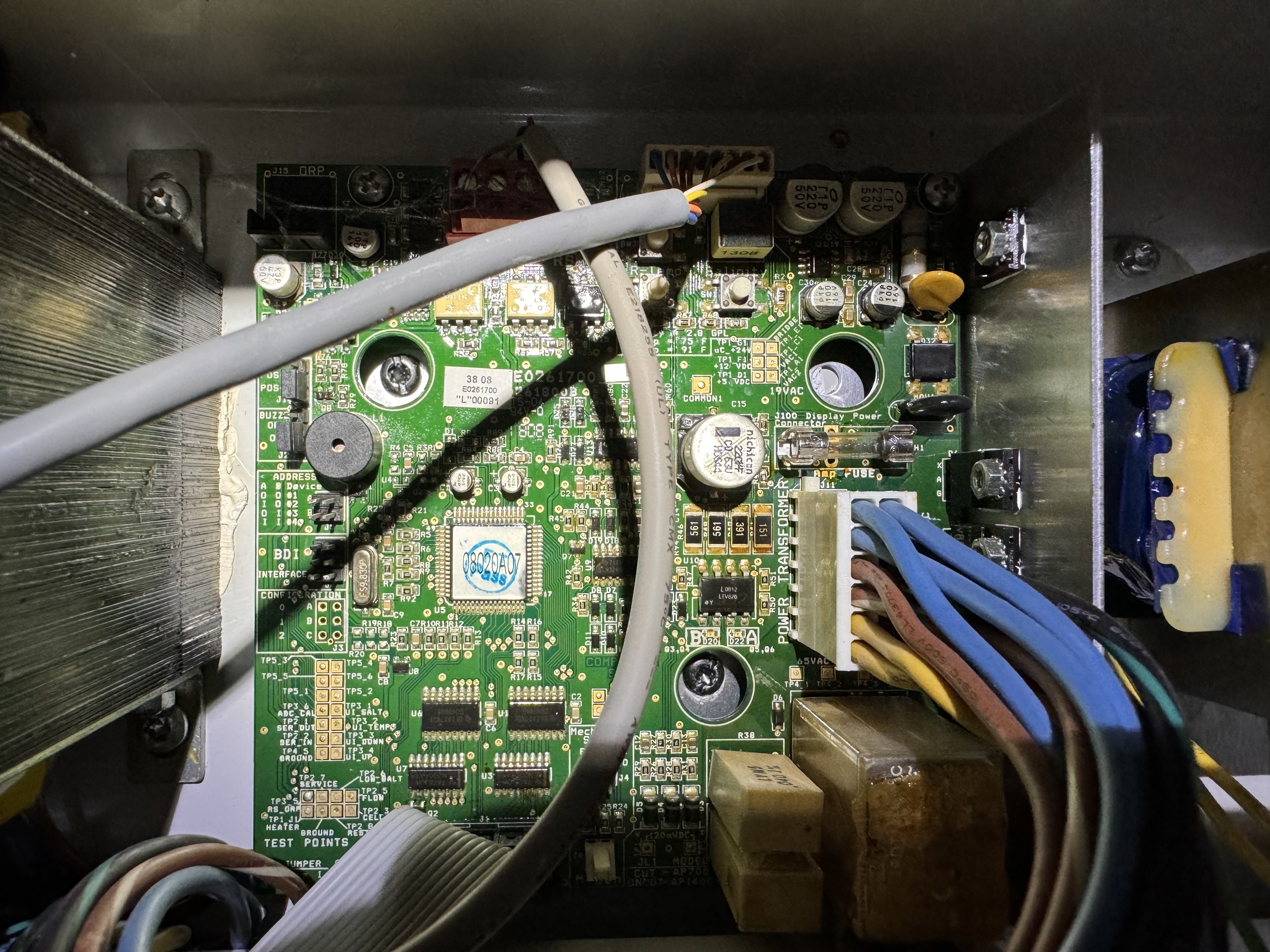

I am guessing this is an AquaPure board problem. Basically I was unable to hook to the iAqualink a few weeks ago. I checked the equipment and a dE error was on the AquaPure panel. Currently the display is blank unless the A and B buttons are pressed. I checked the TFP forum, and this appears to be a rare but documented issue. As suggested, I pressed A+B, and the display cycled up to 60 then 30 then dE. See pics.
I checked my salt cell connections and the 3 pins appear to be good -- I had the salt cell replaced about 3-4 years ago, and included pic of SN. I examined the AquaPure board and display, and there are no obvious damaged/burned connections. I pulled the ribbon connectors and re-seated. Still no joy.
There is a continuous 1/sec beep that appears to be coming from the sounder on the AquaPure board. When I pressed A+B and it went into "dE", the frequency dropped to about 1 beep every 3-4 secs.

The dE code is not listed in Jandy AquaPure Troubleshooting
The best explanation I can find is at...
I would call Jandy and see what they will do for you under warranty. You have a fairly recent system with rev T.2G

So after reading through the referenced links and doing a little bit more digging, I went ahead and got a new aqua pure controller board from Sunplay, for around $209. Just got finished replacing it. That seems to take care of the issue completely. My only hiccup was that the RS8 LCD controller did not come on … I removed and pushed in the serial connector a little harder for a good connection, and that took care of the issue.
Thanks everyone for the advice and it looks like we’re back in business.
