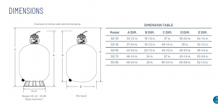

Ok I have disassembled my plumbing and removed the valve body in preparation for a sand cleaning operation. I was a little surprised at the sand level within the Pentair SD60 bottle. 17 inches below the top of the lip, seems like about 1/3 full. Having viewed some of the sand cleaning videos it seemed the sand level should be closer to around 2/3 to 3/4 full? My documentation for the SD60 says 250 lb of filter sand. So can someone give me an idea of visually what that should look like? Or a measurement would be even better. I really dont want to remove the existing sand just to see how much I have. See photo, sand level is marked by top of blue tape. thanks, -sid. SD60 sand level.jpg
Does the present sand appear to be clumpy?
If so, completely replace the sand.
At least you will know you are starting fresh.
Using all new sand is just over 6 bags @ 40#/bag.
Look inside the filter and see if there are any marking designating the sand level.
If there aren't any, the sand should probably come up to where the upper vertical part starts to bend inward.
