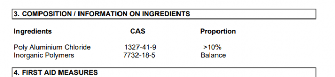

I do love reading SDS from some of these companies.
Hy-Clor's superfloc is a polyaluminium chloride solution. So PAC is an inorganic polymer, although it's probably more accurate to call it a highly complex ion. It does have a number of aluminium ions joined together. The second ingredient listed on the SDS is "Inorganic Polymers" with a CAS number of "7732-18-5". That CAS number is for water. So they give the impression that it's all active ingredients, when in fact it's probably 85% water.
