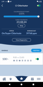

Update.... After turning all Omnilogic panel circuit breakers off/on, I remembered some electronic devices have a backup battery or condenser ??? to keep Clock, memory running during power outage. I went to the house panel and shut off the Pool Panel CBs (total 100amp supply). Waited 30 mins, reboot and all errors are gone. I'm running the system in Super Chlorination mode for an hour and see what happens. I'll post up a Chlorinator Diagnostics (Crazy instant salt reading 65477ppm , Status/Avg Salt (another crazy 39768 ppm reading) Pix after 7 mins running the Super Chlor.
. Any ideas from all this? Sense/Dispense sending bogus data? We've had a lot of Rain this past week. Doesn't add up?
