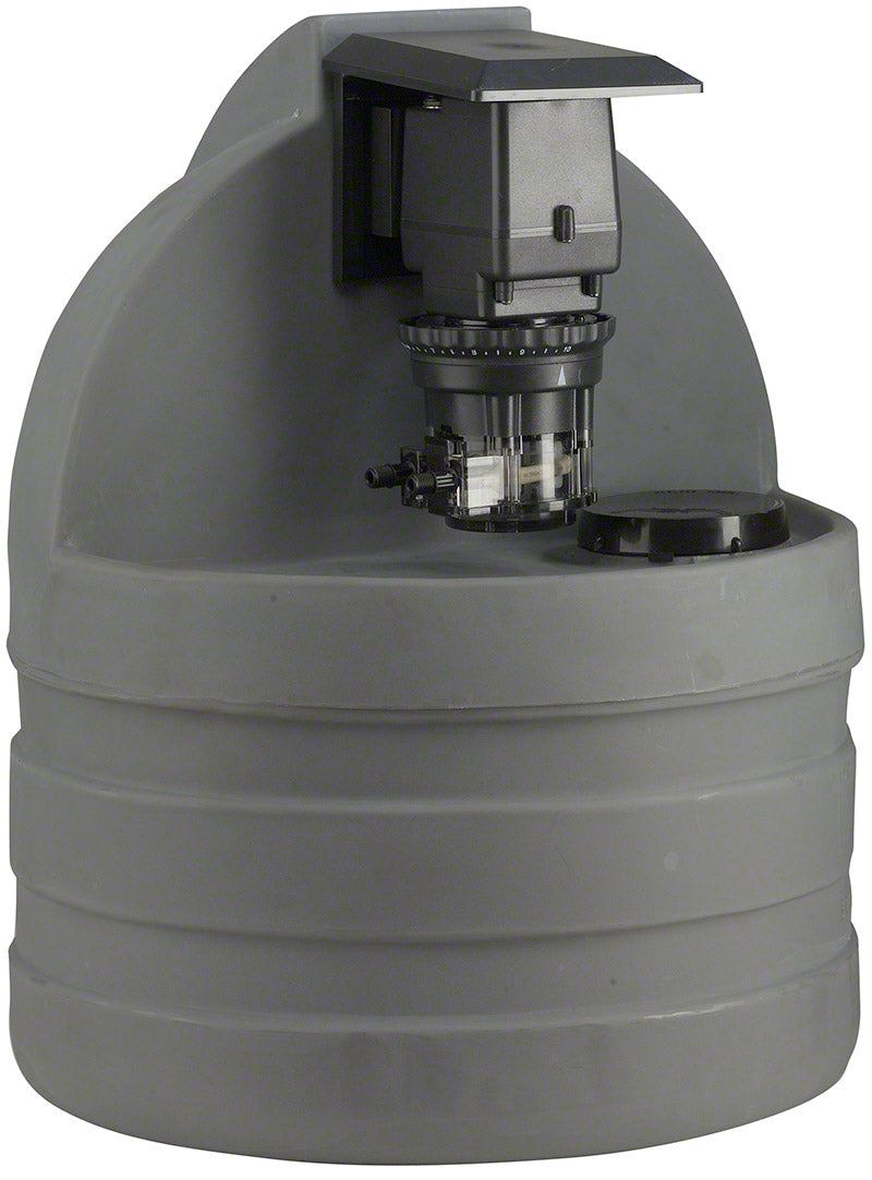

Going on year # 3 now with our pool. Unfortunately my builder set me up with a salt cell that is under sized for my pool. Jandy Tru Clear for a 17k gal pool. If you check my history here, youll see that I need to manually dose my pool in order to keep my FC up. Running the cell at 90% output for 19 hours a day finally took its toll on my first cell.
With that being said, I came across this dispenser. It injects chlorine into your system. There is a timer on it that you can set to turn on and off and you can also set it to dispense xxx of chlorine. So for example, you can set the pump to run from 1pm - 4 pm and during that time frame itll dispense 40, 50, 70oz etc of chlorine into the pool.
Thoughts?
There are several variations of this item. Below is just one of them.
Many people have Stenner pumps like that and they work fine. You still have to buy and add liquid chlorine to it so if there are supply issues, then you could find it troublesome.
Why not just replace your salt cell with a properly sized version?

Jandy over the last 3 years have "replaced" the cell 2 times, but the fact is, my cells were never the issue. So when they tossed the old one in my garbage, and left, I dug it out and put it back in. My original one died a few months ago. I guess running it at 90% for 19 hours a day definitely took its toll on it. So now I have a new one im using and a spare. Once these cells go, im swapping over to an entire new pump/ salt system. Its been nothing buy issues since day one and Jandys CS lacks big time!!!
As far as getting liquid. We are not having that issue yet here in Florida. In my line of work I have access to 100 gallons on my trailer at any given time :)
Doing the SLAM has worked out great for me lol.
Yeah, your cell is undersized. 90% at 19 hrs/day and you still need to add chlorine manually is ridiculous. I have a Pentair IC60 on my pool (same volume as yours) and it runs at 25-30% for maybe 8 hrs/day.
I suggest you look at the CircuPool line of SWG’s. Their largest one produces 3lbs of chlorine gas per day and they are super easy to DIY install. They may even have a mod-kit for their cell that allows you to directly replace the Jandy without having to do any replumbing.
Of all the equipment manufacturers out there, Jandy has always had lots of complaints and they are against any DIY work. So they are the bottom of my list for recommended pool equipment manufacturers.
