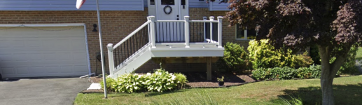

Front of house. You can see the exit pipe to the right of the garage door. Shed is out of sight to the right/behind the house.
Edit: I suppose it could - perhaps just very very close to the slab of the house and runs parallel under the stairs and all the way around.
