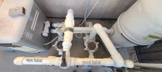

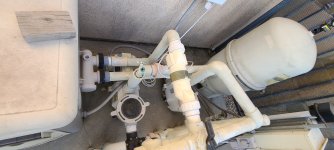

Just moved in and Need help understanding my valves. If I close the spa inlet my spa overflows into the pool for the waterfall but I don't want it overflowing all the time rising my ph. If I find a good balance with the pool inlet and spa inlet so the spa stays full but doesn't overflow, when the pump shuts off the spa drains into the pool causing the pool water to rise and drain out the overfill. So my water is constantly draining when pump shuts off and therefore my salt and calcium is constantly being lowered. I have a automatic fill. Should I just raise the float?

With the valves as they are currently set in your pictures the check valves should prevent the spa draining back to the pool when the pump shuts down. So I would guess that either one of those has failed, or the pool vs spa suction valve (what you labeled inlet) does not fully close off the spa drain.
Lacking automation I would set the valve on the line you have labeled 'spa bypass" to be open just enough to provide a trickle of water over your waterfall, this is needed to keep the SPA water mixed with the rest of the pool. With automation you could set the spa to overflow for a short period daily to accomplish the same end (and do away with the "bypass" valve entirely).

Assuming you are truly talking inlet (at he pump intake) and not what you have labled inlet on pic 2, You cannot control it here as there is no way to avoid the spa draining when the pump shuts off.

You have a makeup line (the one you have marked spa bypass). When operating in normal pool mode the the three way up top after the swg should have off pointed to spa. Then you can control flow to the spa with the blue handled ball valve. Short of automation, you will always have some flow over the spillway.
I'm losing water everyday when the pump shuts off, because when the spa drains into the pool (spa water drops 6 inches below tile) the water rises high enough in the pool it drains out the pool overfill drain. What I have labeled inlet is the pump intake. If I close off the spa side at the 3 way return at top will that help stop the spa from draining when pump shuts off?

Set the both 3-port valves so that the SPA is totally off (handle opposite the pipe to the SPA). In that state you will likely still have a significantly waterfall spilling out of the SPA when the pump is running. Now shut down the valve on the the "SPA bypass" line until you get just a trickle over the waterfall edge.
The suction control valve should always be either fully to pool (for normal operation, including the small spillover) or fully to SPA (when heating the SPA or possibly when brushing the SPA to pull the dirt out the SPA drain). If that valve is partially open then when the pump shuts down water from the SPA will flow out it's drain though that valve and out the pool suction line into the pool. If you want to modify the plumbing to prevent this the cure is to add a check valve in series with the pool suction line.
This picture? If so it is labeled wrong as this is your return - Close this valve, off pointed towards spa return
This is the suction side, looks like spa on the left, pool on the right

Correct, if it does not, then most likely the existing check valve flapper (on the spa bypass just left of the blue ball valve) is bad. the flapper in it can be replaced by removing the 8 phillips #3 screws.
Oops yeah the top is the return. It was a long day! LOL. Thanks I appreciate your help! I adjusted it all this morning
