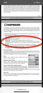

Greeting, in 2023 we built a new pool and had the Aqua rite S3 tcell S325 installed. Shortly after, it stopped producing chlorine. The salt cell was replaced yet the problem still exist. It is reading 200ppm for average salt, yet salt levels are confirmed at 3000. Cell Current is reading 0.00a but voltage reading 28.5. Any advice?IMG_4668.jpeg
