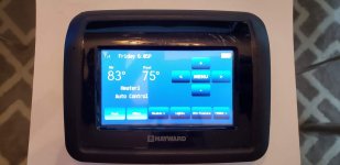

Hello All,
I have successfully replaced the battery in an AQL2-POD2 remote unit.
Given the unit's original housing integrity, it is still water tight.
The result is a unit working with an even better battery capacity than when the unit was brand new.
Please note: an improperly sourced replacement battery could be dangerous and result in fires.
Please feel free to message me as I offer this repair to folks who are interested.
