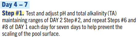

- Day 4 says to begin adjusting CYA to 30 to 50 ppm
- Its worded strangely.
- Do i add 10 ppm per day for 3 days to get to 30?
You need to add about 100. Add 25ppm 4 times over the day.
- Do I follow Day 1 route for CH here brining up 10 ppm at a time waiting several hours between each?
