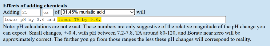

Yesterday I added MA to continue bring down my TA. I tested pH of 7.6 and TA of 100. I added 25 oz. MA. Today I tested to follow up on my SLAM and look at the TA and it was 50. Ran the test again because it change so quick making sure I counted the drops.
Can the total alkalinity change that fast? I cleaned my test lit with alcohol and tested again with the same result.
