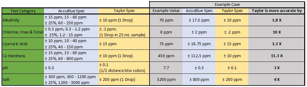

Looks like your results are from the pool store. You need a good test kit…link—>Test Kits Compared
Why? Pool store testing is notoriously wrong. Giving advice on wrong test results, we can do more harm than good.
Add enough CYA to get to 30. No more.
Add 5ppm of liquid chlorine per day until the kit arrives.
Post results from your kit, and start the slam process after you get your kit. Link—>SLAM Process
The fancy testers like to give very precise results, but as you are finding out, precise does not mean accurate and repeatable.
Get a more accurate test kit, then your focus should be on FC and SLAM. If your CYA results are remotely accurate, ~30 CYA is perfect for a SLAM so dont add any CYA just yet.
I just want to make sure I dont send myself into a counteractive spiral where I’m fighting myself and spending tons of money on chemicals because of my lack of knowledge.
Unfortunately, The photometer is going to do that to you. If the FC isn’t staying up, then it’s being used up fighting algae even though you can’t see it yet. You can’t do the SLAM process without the more reliable kit.
