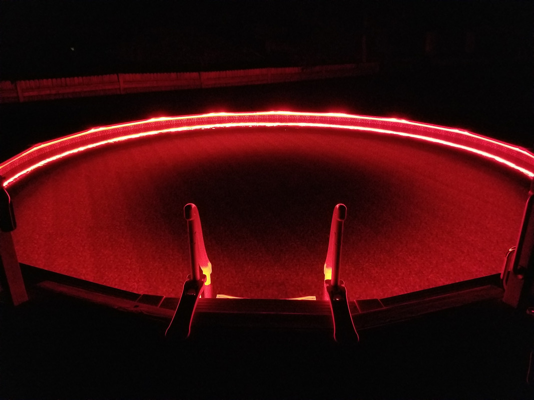

I have the led strip under the top rail. They are secured to the very top of the bead reciever. It is a 24volt system and is not waterproof out of the package and by no means rated for pool use. The strip itself is encased in a flexible clear waterproof housing however the connections are the main problem and need to be reworked so they are waterproofed. What I did was use clear heat shrink with adhesive that is used when connecting the electrical to well pumps down in the water table. Figured if that can keep the water out of the connections when they're submerged 125ft in the water under ground then it's definitely good enough for this.
They can be on any color or set to fade through all or colors of your choosing via a remote or a Bluetooth app, even flash and change color to music.

The lights I bought online though an led supplier, can't remember off the top of my head, xled or something like thst. I want to say it was like $180 and came in a 96ft long roll. The pool has a circumstance of just over 74ft so I had to order longer than needed.
The entire strip is encased in a flexible clear pvc sleeve so unless it gets cut water won't reach the actual led strip array.
The actual connection is not in the vicinity of inside the pool, the strip goes up and under the top rail and then around the pool. The power supply is plugged into a gfci outlet and is mounded up under the deck in a plastic case to keep water out . The end where the led strip was cut is encased in the clear heat shrink with adhesive inside. I even encased the connection point in the heat shrink just to be safe. As for where I bought the heat shrink, Lowe's. It's in the section where the well pumps and pressure tanks are located.
This is totally not rated for pool use but my dad is an electronics technician and he felt it was plenty water tight so didn't think it was much of an issue around the pool. The transformer and connections are your main concern for waterproofing.
Since the other lights mentioned have their own mounting hardware I'm going to assume you're asking me about the led strips.
My liner is beaded so it's held in place with double sided tape at the very top edge of the bead reciever, right up under the top rail.

You can certainly do anything with the right amount of prep. Rope lights are built no different than the led strip that I've used. Would it be safe on the outside, probably much more so. But it still isn't technically rated for use around water. Obviously this doesn't stop us from doing it tho. :p
As with everything you have to use at your own risk and discretion. I won't tell someone yes it's safe or not. But yes the effect would probably cool.
I can only count 3 times where we were actually in the water at night with these on anyway. Mainly I wanted it for the look while outside or sitting pool side.
