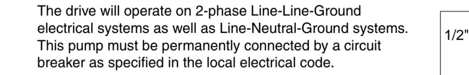

My electrician was asking me if it requires a "Neutral". Do you know if it requires a Neutral?
Ok I had a minute but couldnt find the 3HP manual. The 1.5 only has 2 lugs so no neutral. I'm moderately certain the bigger pump would be the same. Lol.
