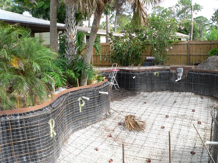

I am just behind you with my pool build :-D except I will have to plant vegetation around mine to get your automatic lush tropical look! Very nice layout and with a black pt, it will look awesome. It is always interesting to see how pools are built in various areas of the country, it looks like you have loose sandy soil compared to our usually hard soil - hence the black walll wrap??

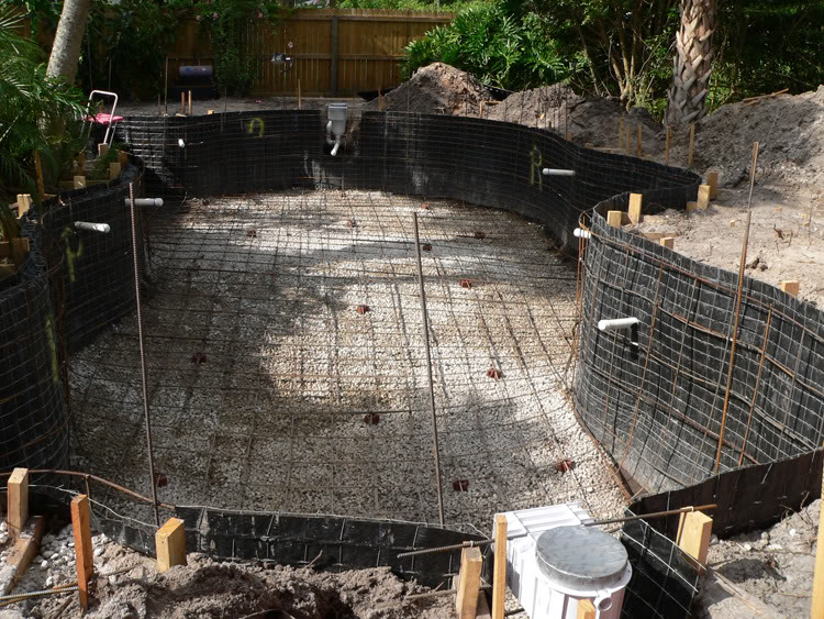

I look forward to seeing your progression, I dig mine on Tuesday...trying to get the gas line Wed and Plumbing Thursday and if all goes perfectly steel on Friday.....we will see how the best laid plans pan out :?
steel just about done!

Buggsw, your friends pool is awesome. That is exactly the look I am going for. Thanks for the picture. Yes, we are planning on using a black pebble finish to get a very dark blue water. Can't wait! :-D

You pool will have a natural beauty to it. The existing plants and trees are awesome. I wish TX had that FL vegetation. Keep us posted I can't wait to see the finish.
The depth is 3 feet to 5.5 feet. The edges around the deep end are a bit shallower and the bottom is shaped like a bowl. We did this for the kids so they could walk around the entire pool, but still have a deeper middle area. We could not go a full 6 feet because of soil water issues, but that is OK. We did what we could do. Ron

Thanks for all the comments. My friend and I have been working hard the past week or so. I cannot ever remember being this tired. However, things have gone very well. Can't wait to actually take the plung. Today we will be doing the plumbing and tomorrow we will be putting on the coping stones. Final finish is scheduled for early next week. I will put up more pics as we move along. Ron
