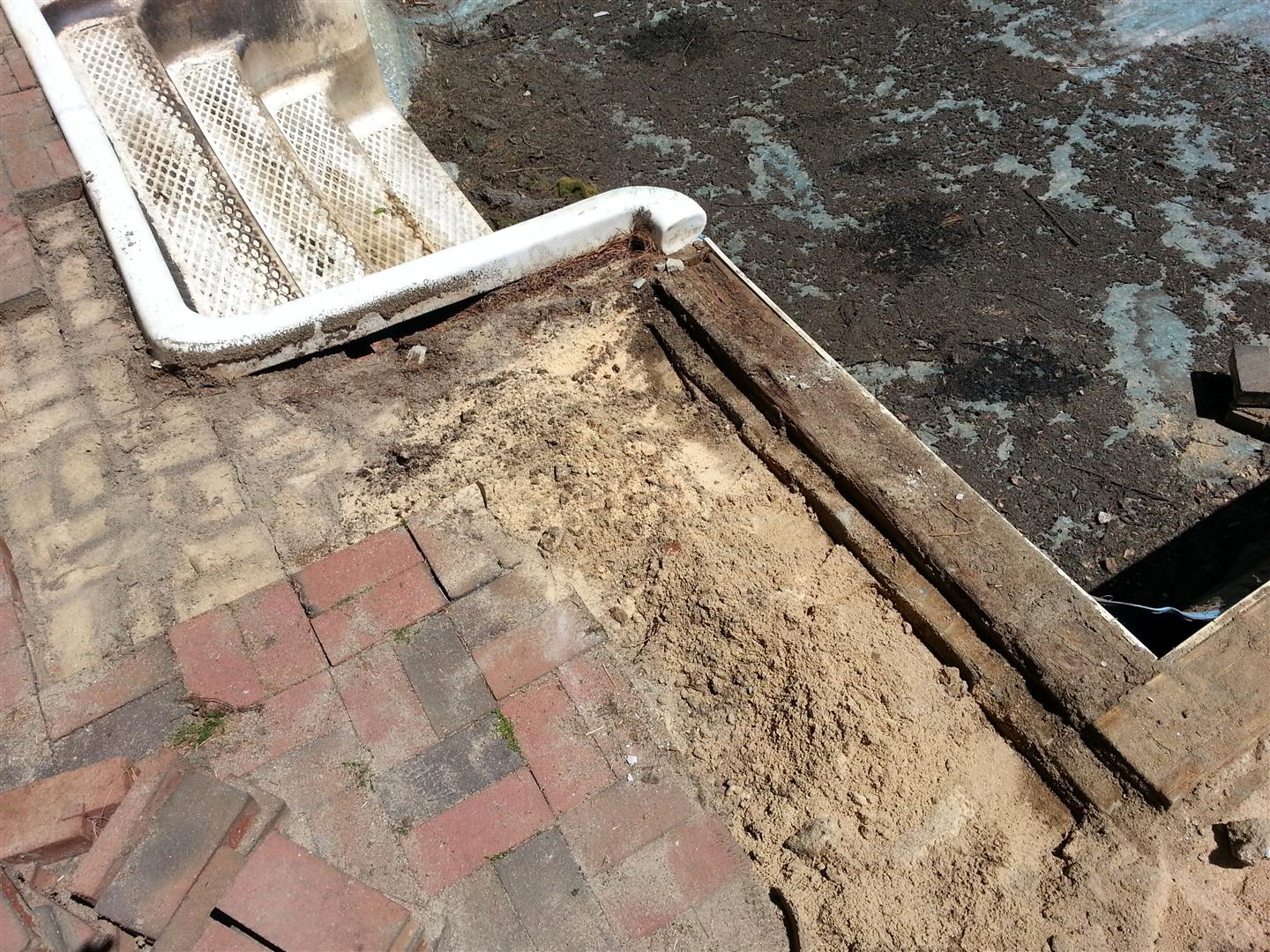

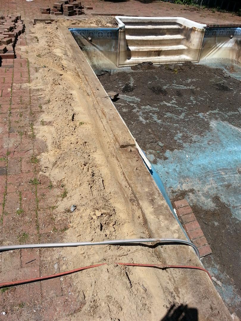

Got started with the deconstruction process. Had a very busy weekend, so I only had a few hours to work on it, which is probably a good thing considering how sunburned my shoulders got in such a short amount of time.
The deconstruction begins. We pulled back the first few courses of brick to expose the wood beam.
We pulled up one section of rotten beam where the liner had already pulled away. The cement walls look great. No cracks, and they seem to be perfectly straight and level.

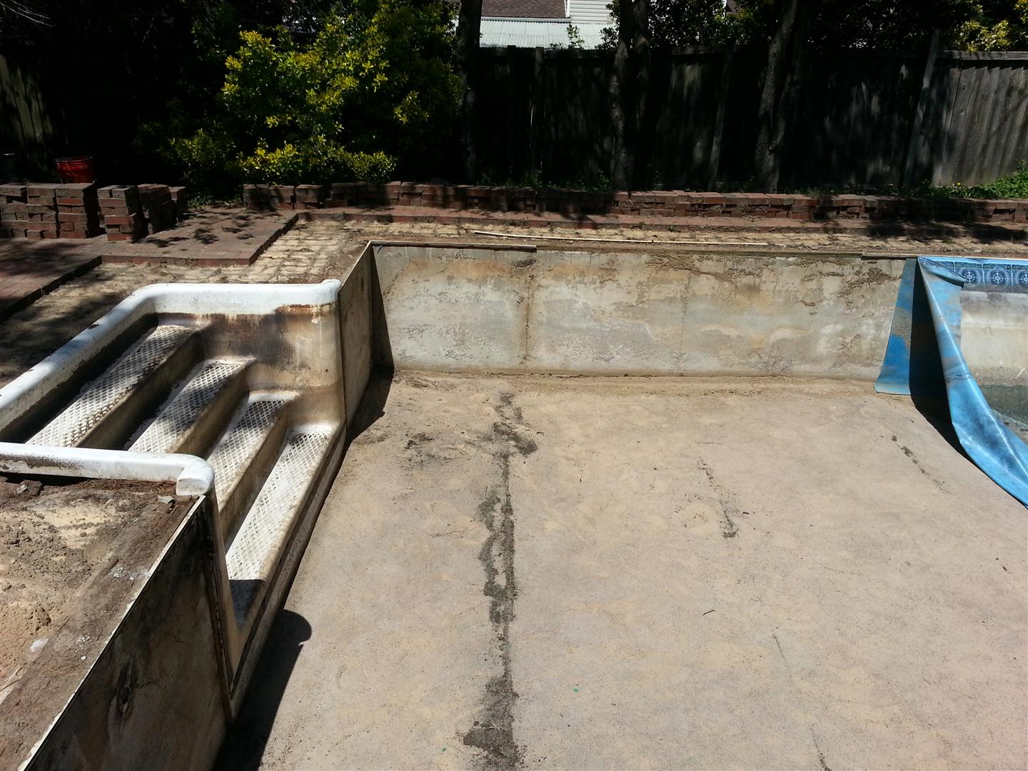

After a couple minutes with the pressure washer, I quickly realized there is no saving these stairs. Which is probably for the best, since the outdated 1970's appearance would have driven me crazy. Its a costly hit to take, but if we dont do it now, we cant replace them till the next time we replace the liner, and we'll need to pull up brick work then too.
Pulling the liner and foam from the shallow end, we can see everything looks to be in pretty good condition. Ill need to regrade the shallow end, but the walls and plumbing look great so far.

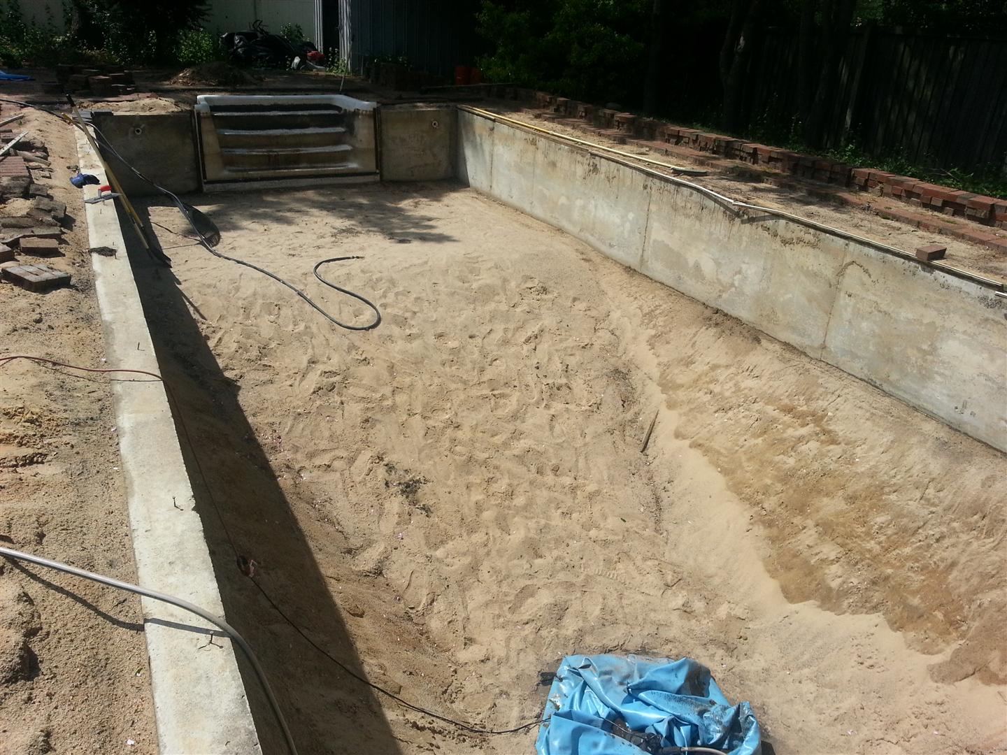

I have a yard of fine sand along with the coping pavers being delivered today. I need to bring the shallow end up an inch or so, at least at the edges. Then once the sand is in, Ill remove the remaining wood boards and cut all the nails flush. Then hopefully next weekend I can begin laying the 2" cement block over the walls, and screw in the liner track.

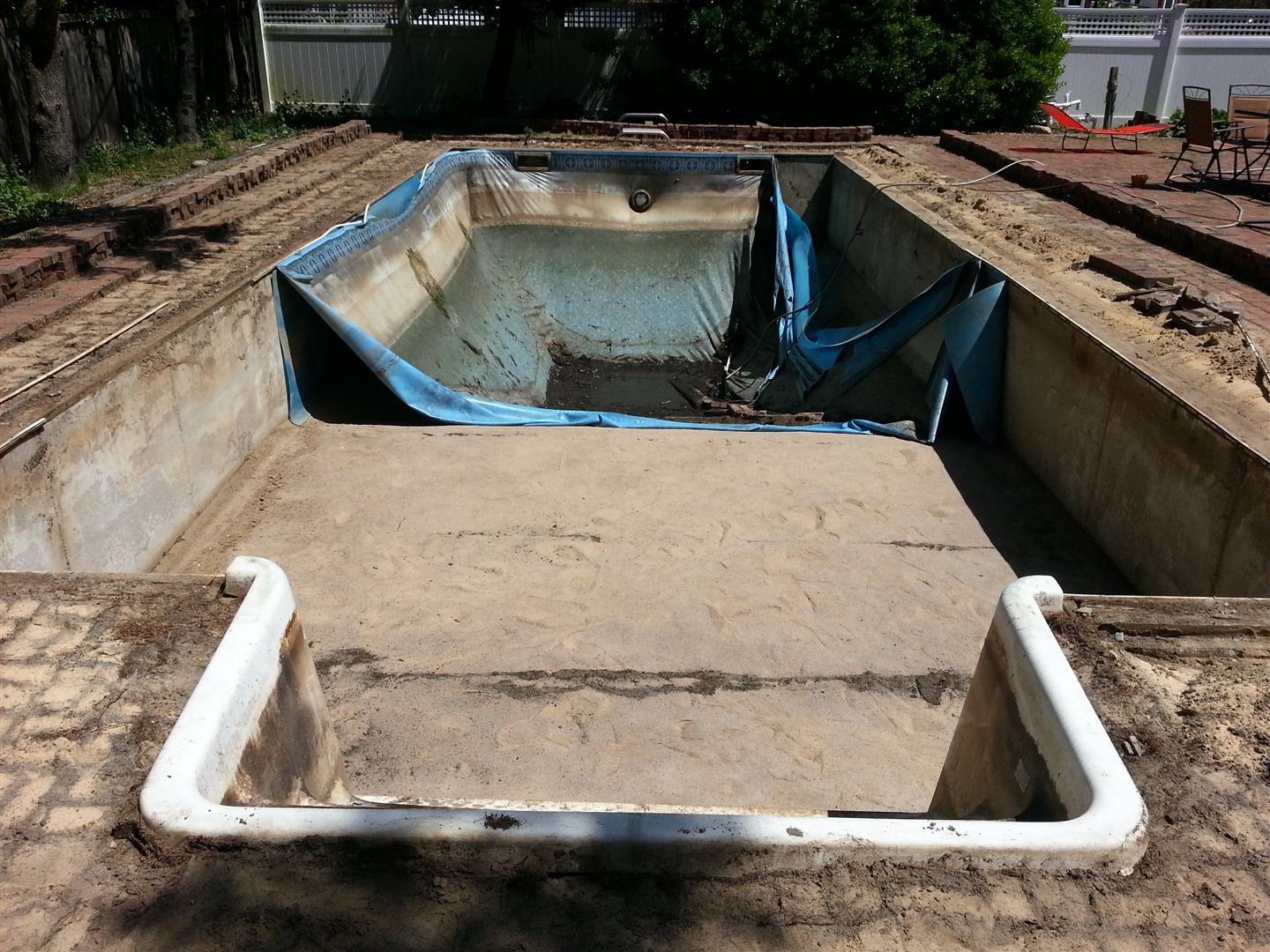

Got the last of the vinyl liner out earlier in the week. Finally received my pavers, sand and pool steps yesterday. Still waiting to hear about the liner, but I dont expect it for a while. I also got the O rings replaced in the filter and multiport. I just need to go through the pump to see how that's doing.
I am contemplating taking down a few hemlock trees that are either completely dead, or very nearly so. I figure these trees will likely come down themselves one way or another in the next couple years, so I might as well take them down while the liner is out.
Hopefully by this weekend, Ill be able to take down whatever trees need to come down as well as wheel the yard of sand into the shallow end. I will try and attack the stairs as well while I have family visiting (slave labor). I need to remove the old stairs, dig out channels for the new stair support legs, attach the stairs to the sides with composite 2x2, then pour cement to set the legs in, then backfill it all.
After all that, Ill still need to strip the walls of the remaining 2x6 lumber, cut down all the old concrete nails, lay the concrete block down, screw in the liner track, re-grade the sand hopper and finally start installing the liner. A lot of work left to do, but at least Ill be turning the corner from deconstruction to reconstruction.

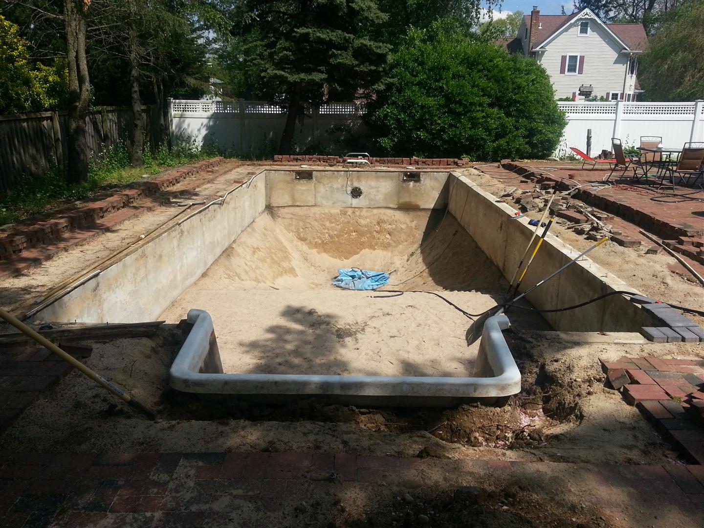

Got a little bit of work done this weekend. We wound up taking 4 trees down in close proximity to the pool. Two of them had to be pulled directly into the pool, so I'm glad we did it now. I also took all the old sand from the deep end and shoveled it up to the shallow end, and then added a yard of fresh sand to the deep end. The fresh sand packs and holds a little better. We then pulled out the old stairs and dug out areas for the new stairs support legs. I need to mount the composite 2x2 to the stairs and walls before I can put the stairs into place and pour concrete around the legs. All the same, things are moving along nicely.
