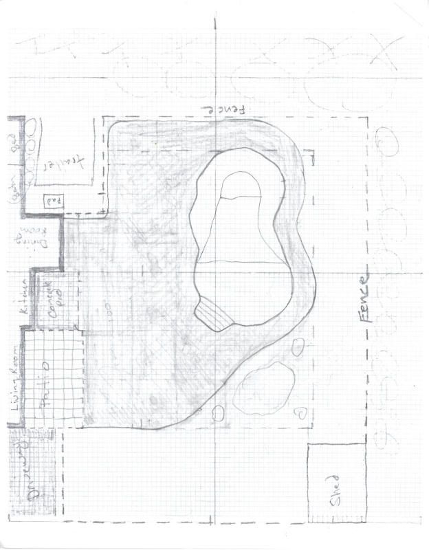

As waste said above, I also suggest getting at four or five returns...it costs just a little more and will save you a lot of headache. Also, as waste alluded to, it would be best for each skimmer AND the two drains to have their own separate lines to the equipment pad - so you can turn on/off each skimmer and the drains individually. Using 2" plumbing will also make the system a bit more efficient.
1400 square feet is a lot of decking, but it really depends on what you want.
It would also be worth adding a line for an automatic cleaner, even if you don't plan on having one right now. It can just be capped at the equipment pad for now.
Before construction starts, it's also worth doing to consider where the skimmers will be. In my pool, the wind always blows everything to the opposite end of the pool from the skimmer.
