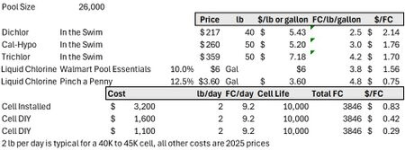

Using tabs, as you did before, would require about 2 per day to counter 4 ppm CL sunlight loss. About $5.75. Starting from 0, it would be much less than 50 days for CYA to exceed 100, and water replacement then needed. (tab use needs to increase to counter the climbing CYA, which increases CYA faster...)
With 10% liquid, it would take a smidge more than 1 gal per day, so perhaps $7. No need ever to replace the water. But there are all those jugs.
As noted, you likely will need even more of either over the course of the summer, but less over winter. The above is likely a pretty low $ number for Arizona if extending over the course of a year.
Make the jump to a Salt Generator, and it will be paid for in 1 to 1 1/2 years. The additional life of about 4 yrs more (and maybe 8), would then be free. And maybe 1/2 of the original cost to replace the cell at the end of life. No more daily adds of anything, or water exchanges.
