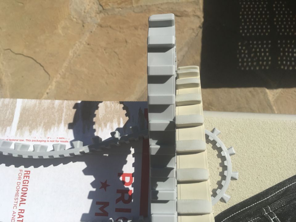

    Belts compared side by side clearly worn, and a lot on the outside edges.

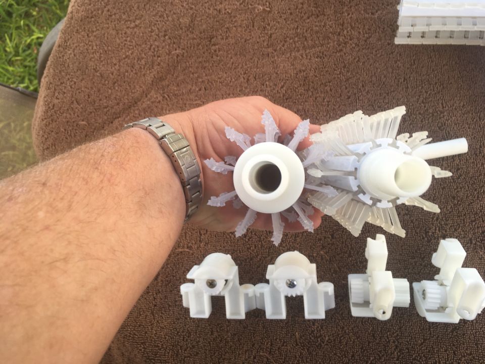

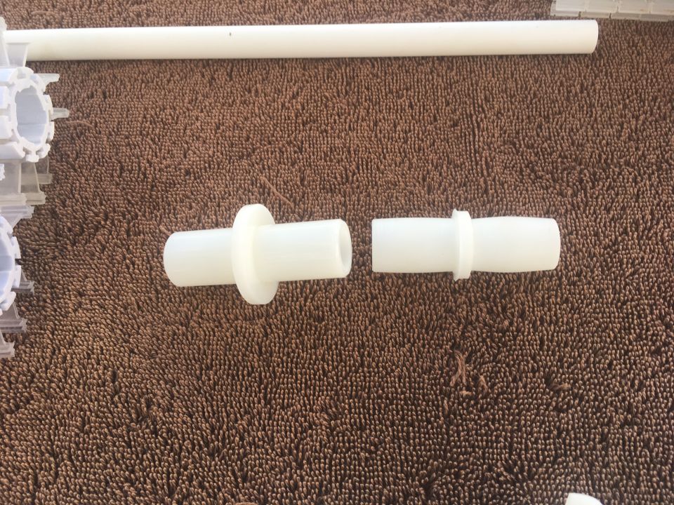

    So I pulled my Bot the other day, and noticed something strange with the bottom brush. Kind of a fluke, as I usually don't look, and I've just recently started sitting him on his side for next round prep. I knew it wasn't right, but thought I would give it a look after filter changes. When I open the carts, there were two strips of bristle in one of them, so this was really weird now.
    Once removed, I found some issues, namely that the center bearing appeared to have a lot of wear, creating slack in the middle. It was actually the slack and mis-alignment or the brushes that first caught my eye. Further inspection revealed severe wear on the final drive gears at the brush ends. You can see the old and new set here, and notice how much play is in the old one.
    In the following picture and the last one, you can see just how much of the center bearing is gone. Pretty astounding so much could be worn away, but as WoodyP so affectionately says, my pool is a sand pit. True enough, as fine blow sand and dust are constant companions out here, but its still pretty amazing to see this happen when it's constantly flooded.
    Unfortunately, none of the parts for this part of the unit are sold separately. You have to buy the whole assy, but after closer inspection and install I kind of see why. If you look closely at the pics, you can see how much the bristles are worn down too. I never even noticed really until editing the photos. What I will likely never figure out is how two strips of them were pulled out of their slots. Something significant happened at the time of failure which was this last run. I suspect the end gears had worn for some time being mis-aligned with with the mains, but something jammed and ripped out two of those strips in the process. Notice how much the gear teeth are worn down here...old and new for comparison.
    But there is more. When the new parts arrived, there was something included I didn't have when I removed this assembly. You can see the tube sticking out the end of the new set there above. There is no question that this created the possibility for this to occur, and or sped the process. Either they forgot to install this when my bot was made, or they have added this support "axle" to later units since then. I highly suspect the former, but will talk to Seth pretty soon and find out. The old parts are made to accept it, so I suspect it was a fluke during final assembly of my unit. If you have an M5, it's worth removing 4 scews to find out if perhaps yours got missed too. I'll report the findings once I know.
    In any event, and at least for mine, 3 seasons of frequent hard labor in the sand pit have taken a toll on wear parts. I have harsh conditions, have never babied this unit, and I'm sure that overall, my conditions are tougher than most. Bad water, frequent use, and lots of mess to clean. I still can't complain, and may have noticed some of these things last season, but again I wasn't around for much of it. I'd say no matter what your conditions are, you should take a look at all this seasons two and three for any replacement or PM work you may need to do.
    Lastly, this answers a question that comes up or has in my mind more than once. I had enough tree wash following some rain to find out the bottom brush makes a noticeable difference having run mine completely without it. After yesterday, its was evident that the new one clearly worked better than the old as well. They didn't go to the cost and trouble of engineering this into the unit for no reason. So if you've also wondered if it makes any difference, it absolutely does. It doesn't really scrub, but it sure sweeps the surface and helps get all the dust and debris up for filtering.

    Yes, I'd say you're right about sand vs. nylon + time = nylon loses. That wear is a bit surprising though. So, what is your running tally for the parts cost?

    Yep, Nylon is definitely the loser every time. I have a feeling Maytronics made the mistake on this latest one though. I haven't found out yet, but I'm sure I will confirm that axle should have been there. Even if it's a design update, it cost me some cash, and I really feel this wouldn't be needed yet. Still, I've had no other issues and wear parts I don't hold against them. All in all I have no heartburn with my cleaner truly back to new. So let's see...
    Tracks and rings-$80
    Dust flaps -$10 (only needed one in reality)
    Bott Brush Assy - $85
    Shipping & handling, and Beer, it's pretty well a $200 bill, but I never considered the cleaner a real cost since it was part of the build, and had I not done it, I'd be stuck with a pressure cleaner setup. I can't say how glad I am to have avoided that. I will say, some of their parts costs make no sense when you compare the different ones, and what they sell for. No sense at all.
