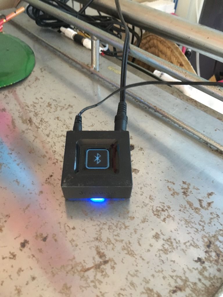

I am utilizing my old Yamaha HTR 5830 5:1 amp connected to Bose 151 speakers in the flamingo lounge and Insigna Rock speakers out by the pool and a Jensen 12 inch 250 watt sub in the flamingo lounge. I have manual switches for volume control pool/ lounge located in the Flamingo lounge. We control all music via iphones (which have lifeproof cases) using BT logitech adapter https://www.amazon.com/Logitech-980-000910-Bluetooth-Adapter-Streaming/dp/B00IQBSW28/ref=sr_1_fkmr0_1?ie=UTF8&qid=1491746982&sr=8-1-fkmr0&keywords=logitech+bt+controller Our system is very PRIMITIVE and I am always on a tight budget however it rocks, the neighbors hear our music 3 houses away, we movies and NASCAR in 5:1 in the pool and sometimes we can feel the vibrations from the sub, by then we have had a few adult beverages :cheers:

Logitech BT controller
