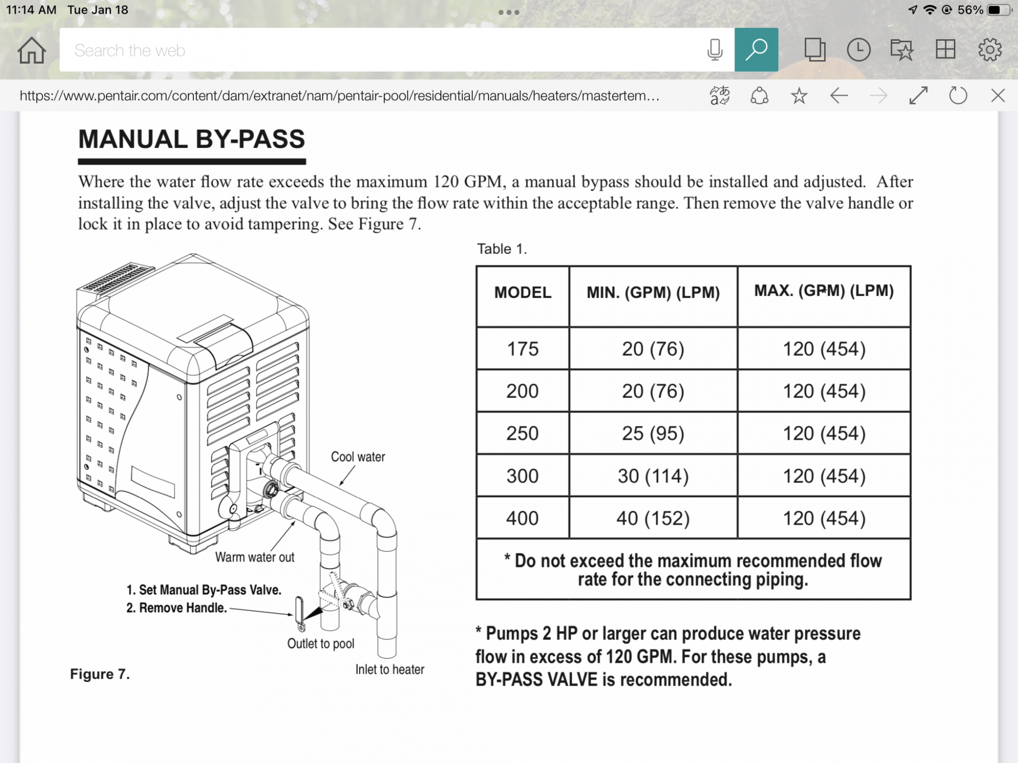

The MasterTemp 300 needs at least 30 GPM. So that will need a few hundred rpm more then your SWG.
