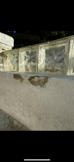

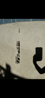

Hello! We want to get around to doing something to this pool but I'm curious if anyone can tell me what it's made of. Gunite? What appears to be underneath? Concrete, fiberglass, tile? I can't tell. Could we patch these areas, still use the pool and save up to resurface next year? What about painting after patching just to temporarily cover stains?
We know from the past that pool functions properly and we are replacing sand filter and pump just to update them now. Thanks for any guidance!

We are in the process of cleaning it out
Looks like an old plaster pool that needs a replaster. And that skimmer looks broken and may need replacement.
