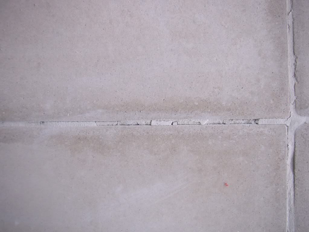

The very thing I tried to avoid with my precast during grouting happened anyway. I knew it was risky having someone else handle it, but there wasn't much else I could have done. I had API seal everything for me because I didn't have the space to lay everything out and do it myself.
I have 'picture framing' all around my paver edges from the grout. They needed to be sealed well and they weren't. I've worked with sealers for many years and did all the stacked stone on our pool. It took 3 coats but when you put water on it, it beads up like it should. I've also got many 'hollow' spots where the pavers didn't bond properly and day 2 after grouting it's already shifting. What's gonna happen when I fill my pool? They used portland cement to float so much of it but I really think it should have been thinset. So, hopefully the picture frame effect will fade, and my deck won't crack everywhere. After awhile, it just kind of takes it's toll. Sucks the fun and excitement right out of ya. Yes I'm excited about the pool being done and it is beautiful, but alot of these things I saw coming and tried to stop from happening, it just wasn't enough.....

The paver guy sent someone over to look at it, and he saw it and said he didn't like the way they grouted and wants to do it over. He's going to check into a different type of grout, one that has some flex to it. I think part of the problem is they didn't pack it in firmly enough also, because on the piece in the photo I took if you push down with your finger, it becomes a hole.
I've been told the picture framing will fade in time, but I've also read it's irreversible. So, I dunno. It's just a shame because it looked nice and clean before it was grouted. The thought of spray deck didn't sound good 8 months ago, but it sure would have been easier, and cheaper, than what we've done.
They probably didn't thinset due to the size of the pavers. It would be tough to get a proper bond on units that big with thinset unless the substrate is perfectly plumb (and I mean like glass!)
The grout voids are probably due to the pavers being so thick and the joints small. It's going to be a lot of work, but they need to remove the bad spots and really force the grout down into the joints to repair it.

They're here now removing the grout. It does seem the problem is mostly from the voids not being completely filled. I don't think the pavers are moving (now anyway) even though you hear a hollow sound when you walk on some of them. Tres, not sure what you mean when you say sealant joints. The existing pad they laid upon had expansion joints, and in the 3 years it's been down we had a few cracks (in the joints) but no visible movement in the slab.
I spent about 3 hours pressure washing yesterday and it looks a little better. There was quite a bit of grout residue left on and I removed quite a bit, but the picture framing is still evident. I told the guys this morning "NO WATER" To just brush the grout off with a broom and that way I can get another coat of sealer on them before regrouting.
They do have some grout bags, and they'll mix it up a bag at a time and work in smaller sections as opposed to how they did it the first time. They mixed it all up in a big wheelbarrow and set it on the joints but didn't work it in right away so a lot of it dried out.

AHHH, there's the problem. It is probably the stuff they did near the end that was way too dry that caused the majority of the problem! If it is too dry going in, it will not have the 'cure time' necessary.

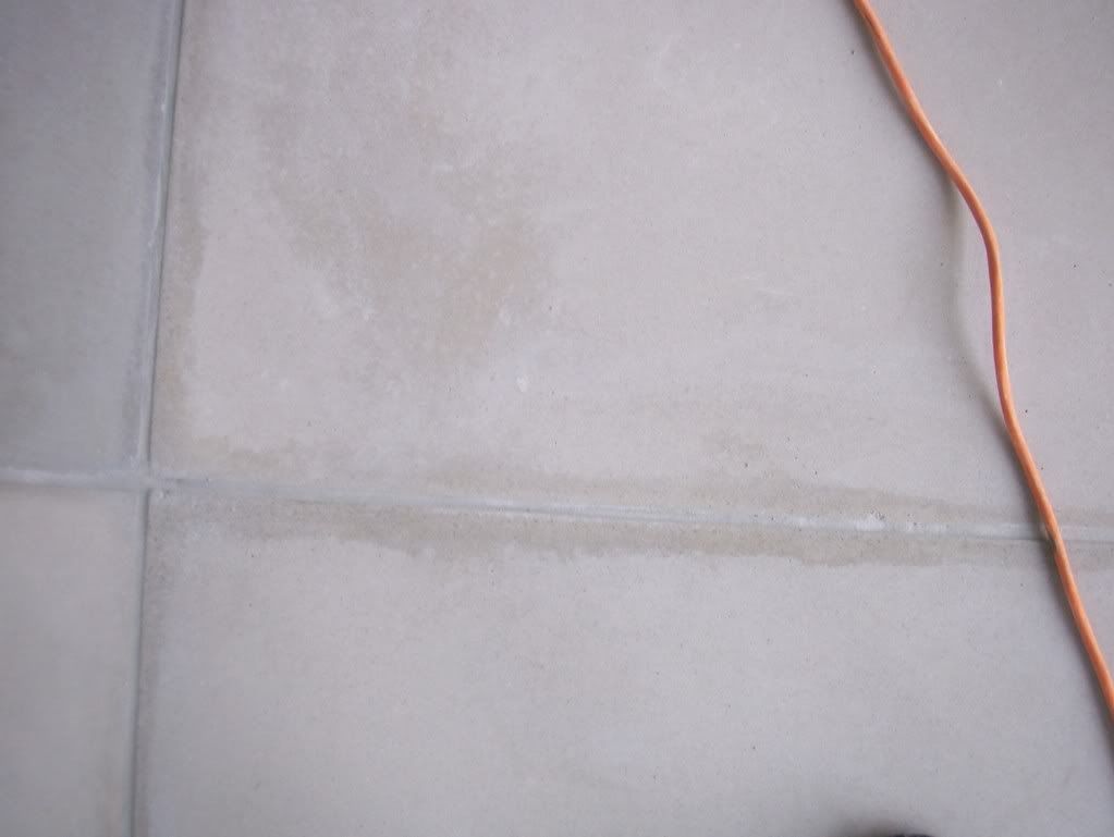

I'm dealing with a very irritating and tricky issue now with efflorescence. So much water has been put upon these pavers and there wasn't a good seal on them from the start. I'm not allowing any more work done until I can get a good coat on, which I can't do until I fix the effloresence. I feel like I'm fighting a losing battle with this deck, geez!

Quote: "I'm dealing with a very irritating and tricky issue now with efflorescence. So much water has been put upon these pavers and there wasn't a good seal on them from the start."
Good grief, I don't think there's anything that can go wrong that you haven't dealt with!! Wait until all the grouting is done because you may get some more efflorescence after that. When that's done it'll probably need a good acid-washing, then pavers and grout can be sealed together. Luckily most of the time with efflorescence it's a one-time event.

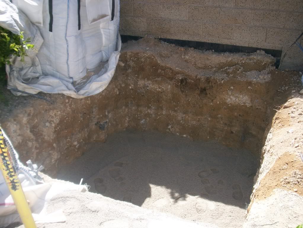

Ok, Casey :wink: Since I'm killing time waiting for them to fix the crane (does it ever end!?) and in between doing samples of vinegar and bleach (no, not together) on my patio, here ya go...
For perspective, the space between the wall and the start of the pavers is 10.5 feet. Hard to get a good pic because of the tight space and all the bags of dirt.
No kidding! I don't know what else could possibly come up, but nothing would surprise me. I'm worried if I don't seal (keep in mind this is water based penetrating, not coating) I'll get more haze/residue (which is another problem I didn't mention) and more picture framing than I already have. I know I'll need to go back over it after the grout.
Both the bleach and the vinegar samples seem to have worked. I'm not comfortable working with muriatic so I'll do the whole patio with the vinegar probably, then a coat of sealer which will basically act as a grout release. I'm trying to find out though if I need to neutralize it with something beforehand or would letting it dry out for a few days be enough.

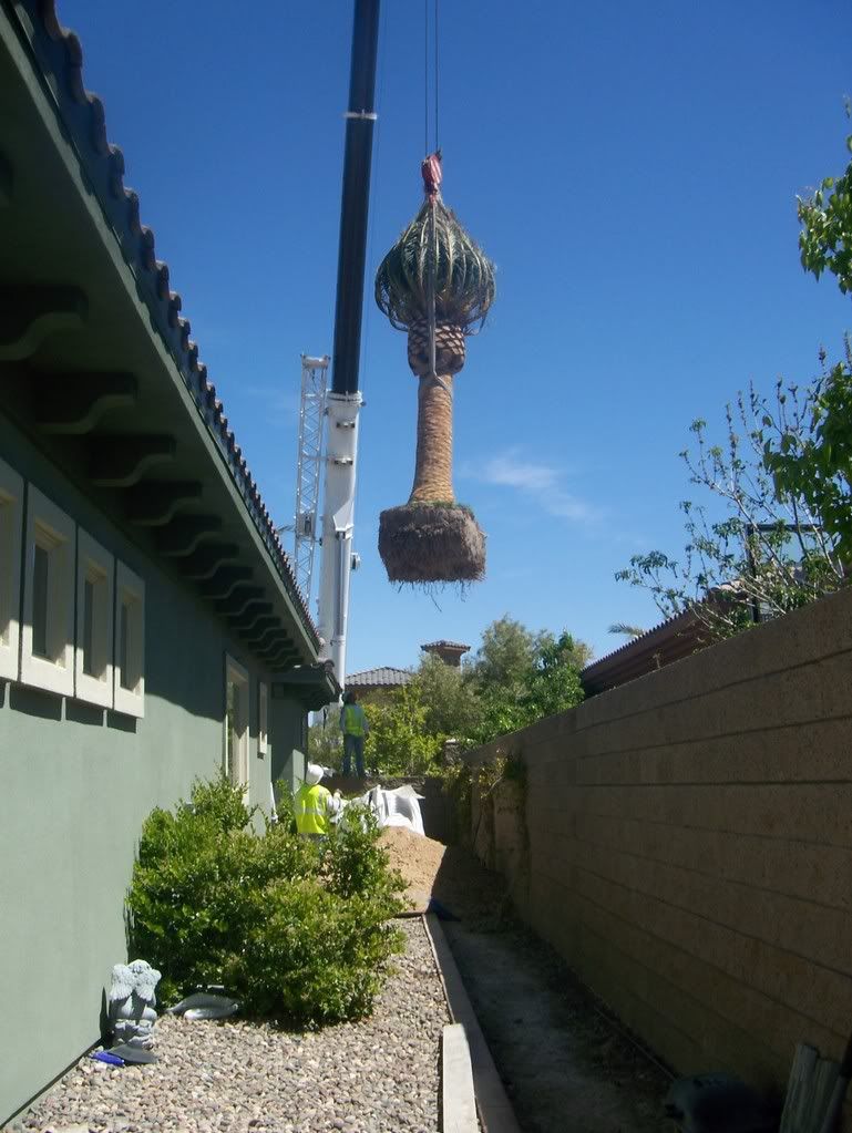

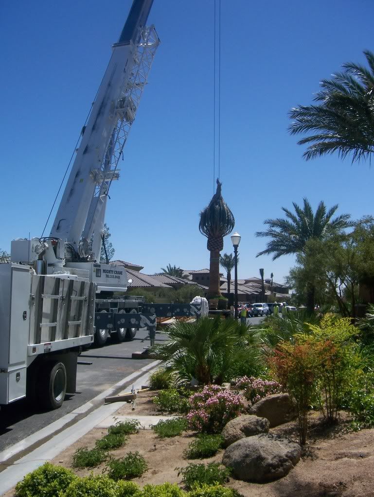

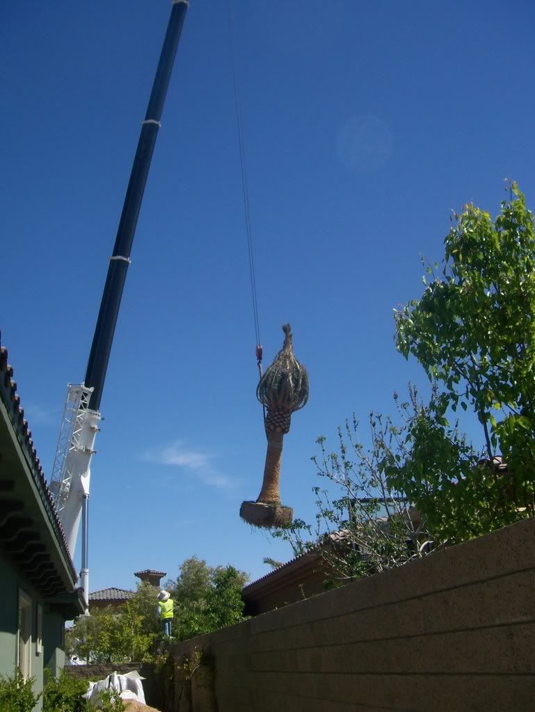

A little off topic, but here's the tree coming in :) 120' crane bringing a 16' palm in between a 20' or so space. Pretty cool to watch! I video'd for the hubby...

That is soooo cool Vegasmom!
Thanks for the pics! Your DH should enjoy the video!
