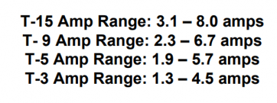

The Aquarite and Aquatrol shut down according to the amps.
The T-15 shuts down at 8 amps for most software versions except a few versions that shut down at 10 amps.
I think that a T-9 is also 8 amps.
I don't know the amperage for the T-3 or the T-5.
Higher temperatures do increase conductivity and cell performance.
In some cases, high water temperatures will cause the cell to shut off at normal salinity levels especially when a heater is running.
For example, if your water is 90 degrees and the heater is on, the water exiting the heater and entering the cell can be 107 degrees and this can cause a T-15 to exceeds 8 amps and shut down.
In that case, you can change the cell type to T-9 and run the salinity at about 2,000 to 2,700 ppm without tripping the high or low salinity light.
So, you should keep the salinity to about 2,700 to 3,000 ppm maximum and watch for the shutdown during heating.
