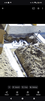

Not without separate suction lines and return lines going to pad. The current plumbing (1 1/2"?) is way too small for spa jets. That small of a pipe really should not exceed 50 GPM which is only 4 GPM per jet. There is no jet on the market that needs that little of a flow rate and even if they did, it would be way underpowered. I don't see how any of this is going to be sufficient. Unfortunately, I don't think your PB has a clue as to how to design a proper spa.
The plumbing around the spa looks fine, I just don't understand why the PB used such small pipe from the spa to the pump. Any other views showing the pipe runs to the equipment?

Yeah they actually messed that up. It's fixed now and it's 6 on top and 6 on the bottom. I was also able to pull some more plumbing images from my cameras. No idea on the jet size. Also as you can see they put the calf jets very low in my opinion. I am hoping that directional covers turned up will fit it just right. Are there any brand etc that can be rotated more than others?
