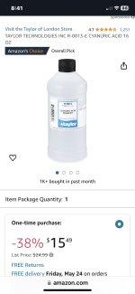

Does this seem legit ?
Taylor of London is seller on Amazon . Reviews were good
Clicking the link brings you to poolweb which is a known online retailer. They are selling it directly for $17 and change.
Or used Amazon for possible quicker shipping and real easy disputing.
