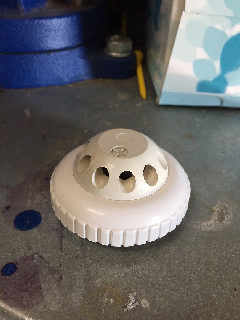

1. The PB replaced all the pool returns (8) with new 1" eyelets but those furthest from the pump have little to no water flow. I suspect this is due to not enough resitance from those first inline. The pool previously had these:
On the old I measure 3 x 1/4" downward-faciing eyelets for each return.
My question - should I replace the 8 returns with 3/4" or even 1/2" for better water circualtion? Pressure on the sand filter is currently reading 15psi.

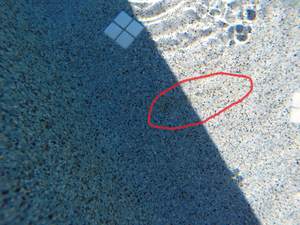

2. There appears to be some sort of orangish-brown stain on one of the steps. Part of it is in the shade so it is difficult to see it in the photo below. I can take another one later in the day if needed.
This was taken underwater with the GoPro:
Is that just a (natural) blemish, a mineral stain, or algae? It does not rub off when I brush it.

1. Yes, change the returns. I doubt your returns are on a loop so there are some that are "far" from the pump and others that are closer. If you which ones are which, you could try larger eyeballs on the ones farther away to balance the flow better.
2. Dude, nit-pick much?!?!? Just kidding, I'd be totally OCD about that too. Drop a vitamin C tablet on it and see if it lightens it. It looks like a natural variation in the PebbleTek but always worth checking.

As as for the stain (or whatever) I would not be a happy camper It would stick out like a sore thumb and make me a little crazy. What will vitamin c do to it??? Or what do you hope it will do and if it "works" what does that mean? Algae?

Vitamin C (ascorbic acid) will remove metal stains (mostly iron but also copper if it's not too old). It's a quick way to test to see if a brown stain is metal. If it fails the vitamin C test, then you can rub the stain with a trichlor puck to see if the concentrated chlorine lightens the stain. If the trichlor puck test is positive, then the stain is organic in nature (or biological in the case of algae). If it responds to neither of those tests, then what you have is mottling of the plaster finish which is not easily corrected. I have some faint brown stains on my PebbleTek finish because the guy that came to do the final acid etch to expose the pebble finish was not careful around my rock waterfall and he let some of the acid drippings from the rocks run down the plaster finish. So I have some light mineral stains there...I just consider them "birthmarks" and something that is unique to my pool, i.e., trying to "fix" it would be more of a headache then just learning to appreciate it for what it is.

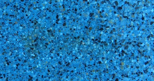

I did the vitamin C test first followed by the puck. No discernable difference so it may indeed be an abnormaility in the pebble. Here is a closeup - perhaps it is just a cluster of darker stones. Odd that this does not exist anywhere else.
I ordered a 5-pack of 1/2" returns. I'll put them the furtherst upstream to see if they help the 1" eyeball jets at the far end of the pool.

PebbleTec is not perfect. I have plenty of little perfections like that in my finish. It can often happen from the aggregate not uniformly mixing with the plaster base. It's nothing more than an aesthetic issue and, in your case, seems pretty minimal. Just think of it like a birthmark on your new born baby - no one is going to say, "Oh my gosh, quick, call in the plastic surgeon!!" You just accept it as part of your kid....your pool is your kid.

The return plumbing as it interfaces with your gunite shell is typically 1-1/2" internally threaded PVC pipe. So, you can simply screw in whatever eyeball fittings you like. There's a whole world of different fittings, some better than others.
