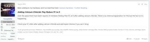

Bleach addition was after I read this:
It's rare but possible. Prove there's no algae. Prove the CYA will hold FC the next few days. Then we lol and shrug that it must have been the CH.
Indeed. Was wondering whether to add my story to that other thread. Going to hold off.
If we disprove everything else, then the Calcium is easier to blame.

I wonder if the large Calcium Hardness addition freaked out the SWG and it shut down? I should probably inspect the salt cell to see if there's any calcium build up.

so about 20 more lbs of Calcium Hardness Increaser. Last time it took my FC down to 1.0 in one day when I added 25 lbs (passed the OCLT test, so I think it was the chemical)
