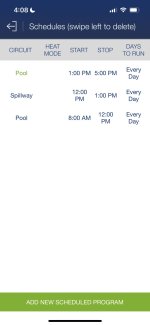

Show me all your schedules...

Here are my schedules:

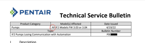

The issue is with the firmware, not the hardware.
Anything that is 3.03 or 3.04 needs to be updated. That is the directive we have from Pentair.
I cant believe it I called Pentair and they gave me a case number to come out and do a firmware update even though the pump was installed in 2016. I really appreciate that. I will see if it is free or will cost me?
