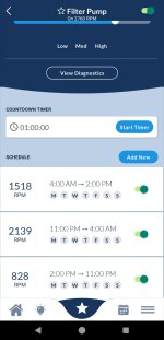

828 RPM is really low.
Can you confirm that you have actual flow?
What happens if you increase the speed up to about 2,750 RPM?
It hasn't changed the temp. it fluctuates around 129-130.
This is my current schedule. I used an online calculator to make sure i have at least 3 turnovers. The RPMs coincide with cheaper electricity rates. If its wrong, I'm willing to rework it for a better schedule.
