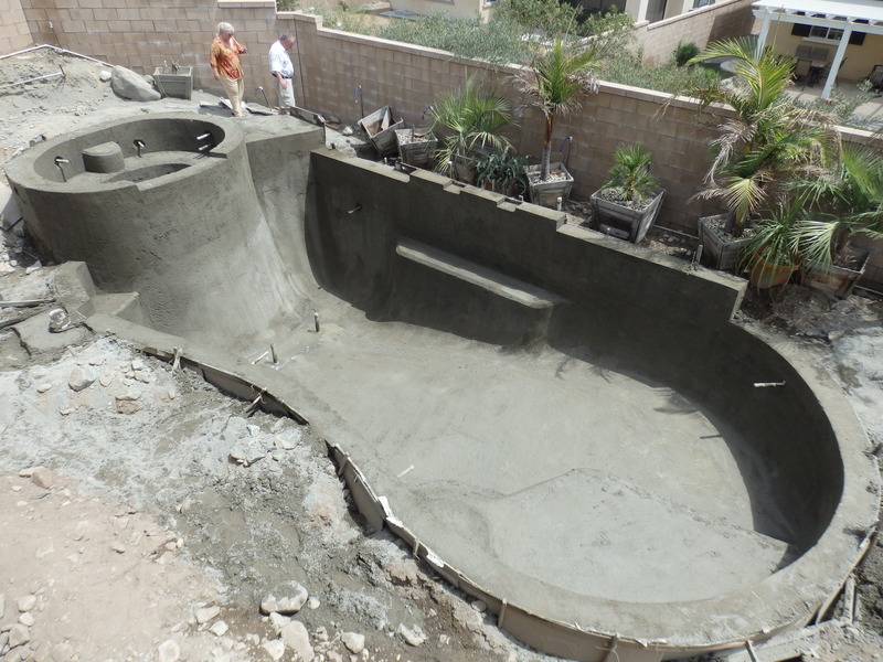

So, the gunite is done!
Here's the overview, hooray looking like a pool! Watching the guys was exhausting and I feel like I shot the pool myself (I did do some back-filling in a side planter today so that might have to do with it).
Exciting to see the light in the pool! We did some rough measurements and the depths seem about right. 3.5' shallow and 6' deep.
View from up by the jump rock... the leap of faith rock hehe. The swimout is nicely sized and will allow several people to sit there comfortably. Same as the spa, this setup will be for comfort and space, no tiny seats in this yard!
I'm proud of the baja reef and step design (my own creation). It allows half the family members to walk directly into the pool, and the other half to walk onto the baja reef. The baja reef is a happy medium between the people that wanted it larger, and the people that wanted it smaller... so, it's in-between in size. Note the fill spout to the right of the light. It'll be nice to not have to toss a hose in to fill the pool (memories of my grandpa and his pool).
