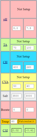

Interesting call out. I didn't actually realize there was a signifcant difference between CSI and LSI and I like the Orenda calculator for LSI vs the Pool Math calculator for CSI because its a lot easier to see 'what if' scenarios, but since discussion here tends to use CSI I'm going to switch to that instead. Plugging my numbers into the PoolMath calculator, I would have to bump my CH to over 800 to get my CSI down close to 0 let alone slightly above with a TA of 50 and a PH of 7.8. I guess those here who have there TA low are running PH high and pushing closer to the lower end of the CSI acceptable range ?
I was trying err more on the safer side of 0-+30 for two reasons, I'm not completely comfortable that I can keep the pool in balance yet, and perhaps more to avoid further research, ie. what are the effects the further to the negative side of the scale you slide. WHo decided -.31 is bad and -.29 is safe?
Ah, I should have caught your were trying to stay above zero. Everything I’ve read says to stay slightly negative to avoid scaling. I don’t specifically target a specific pH but it just like to kinda top out at 7.8 most of the time. If I try and lower it below that too much it’ll race right back to 7.8 and hover there. Have to add acid a little bit as it hits 8 very slowly compared to how fast it rises from 7.2 to 7.8

0.00 is perfect.
Anything above risks scale and anything below risks dissolving calcium carbonate from the plaster.
It’s an exponential scale and it has generally been accepted that being within about 0.3 above or below 0.0 is “safe”.
Safe is a relative term and you have to consider the normal fluctuations and the long term effects.
Within about 0.3 above or below will generally have very slow effects for corrosion or scale.
I don’t have any definitive studies that show the long term effects of maintaining any specific level of CSI.
My observations have been that once you go significantly above or below 0.00 by more than about 0.30, you begin to have a higher risk of noticeable problems.

Thats pretty much in line with everything I've seen thus far. My thinking is that since its an imperfect science, although neither condition is desirable, I'd rather error more on the plus side of having a small build up since its noticeable and more correctable vs. etching, corrosion etc. and, I don't want to digress the thread but Im also having some issues with what appears to be plaster sediment (blue/tan) in my vacuum bag on a weekly basis, 2 years after the finish was done. I've had a lot of issues with this finish, initially significant issues with staining from 'organic' material that got in the mix, that lasted about 6 months and is still going on to some degree, and I'm concerned that this is going to turn into a warranty issue with NPT, so I'm trying to rule out any possibility that water balance (negative) is the issue.
ANyway back to the poolmatch CSI calculator, if you try to get that very close to zero with the other nuimbers constant you will see the CH bump up very high

THe suggestion was to run TA at 50 to keep the ph from running up, and during swim season I wouldn't keep my ph above 7.8, that could lead to sacrificing bather comfort for the sake of the chemicals which seems backwards to me. Also my borates are at 45, supposedly to help stabilize the PH. With those 3 changes at 800ppm CH I am still just slightly below zero (-.12) at 75 degrees.
