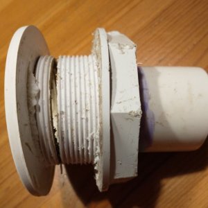

I will add one final thought because it applied to me. During a pressure test, it held, but we knew I still had a leak. That leak was determined to be inside a return jet itself just behind the eyeball. See the pic below. If ADL pushed testing plugs deep into the return (PVC) lines during their testing, they would not catch a bad jet fitting. With a new pool like yours that shouldn't be an issue, and/or ADL did in fact inspect those closely. But I figured I mention it. Otherwise, your builder really needs to make things right for you. I hope you are able to keep a good dialog with them so that things don't get ugly and communication shuts down.
Trying my best to be as amiable as possible. Im also not out to have them do a bunch of work they don't need to, I'm not a complainer - but the pool is none functional the way it is now.
My jets aren't like that, they are just pressed into the pipe coming through the wall, I have wondered if that could be part of the issue. No glue, housing etc just pressed in.
