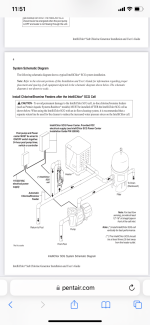

Hi Friends,
We got our new vinyl pool started up and we love it but our Pentair IC-40 SWG can’t seem to get above 3000. According to the manual we should be at 3600-4000 but we are at 2980. They already replaced the salt cell once and said the first one was “bad” but I’m beginning to wonder if it’s not installed correctly when I look at the manual. We do have a booster pump Polaris cleaner so that does apply. Am I crazy or did they not install this correctly per the manual? This is all Greek to me but I don’t see the booster pump being on its own return line and the salt cell looks like it is installed horizontally not vertically. It’s also quite close to the heater. We have one payment left to give them so if this needs to be fixed, now is our opportunity.

Your IC40 installation looks fine. Most installations are horizontal, not vertical.
Your booster pump looks fine.
