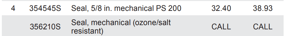

It looks like it comes with a 356210S seal, which should be the Ozone/Salt upgraded seal.
The PS3867 should be equivalent.
