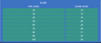

2 - Test your CYA. You need that number so you can go to the FC/CYA Levels to figure out your SLAM FC level.
3 - Increase the FC to that elevated SLAM FC level and maintain it as best as you can while following the SLAM Process page.

Ok then. I figured filling would take longer. Lol. Lower the PH and fire when ready. (y) Your choice if you want to use 20 or 30 CYA as the SLAM target. If it doesn't register in 2 days we'll add more and then it will be a 30 for sure.

Then put in slam level 12 if the cya doesn’t go up?
If you want to be conservative, SLAM at 10 FC (for 20 CYA). We will adjust it to 30 if it doesn't show up soon.
Or to be slightly aggressive, SLAM at 12 FC (for 30 CYA) figuring you had some CYA left and added 15 more. We will adjust it soon enough if it isn't already 30.
