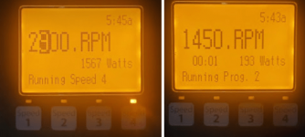

I think your estimates are off. Here's my pump display...
It could just be that VSPs are like that, but it suggests a big divergence between pump RPM and flow. My 2-speed pump has a 3x jump in power (measured with a current transformer) for a 2x RPM increase, nothing even approaching 10x. And my RPM corresponds closely to flow -- I get 16 GPM at 1725 RPM, and a bit more than 30 GPM at 3450. I would expect an efficient VSP pump to have a *closer* correlation between power and actual flow, not less (my relatively inexpensive Hayward 2-speed pump should definitely be less efficient).

The RPM, Watts, Flow I posted are actual readings from my system.
The power usage of a single speed 1.0 hp pump came from a thread on TFP.
Below is a complete chart of my system.
Rpms and watts used are from the controller. The flow rate is best interruption of the analog scale on the FlowVis meter.
RPM Watts Flow GPM
600 27 16
750 52 22
1000 92 35
1250 148 43
1500 240 50
1750 350 58
2000 494 65
2250 695 75
2500 932 85
2750 1230 94
3000 1594 102
3250 2050 110
3450 2418 115
