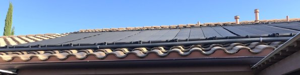

My pool solar is at least eight years old. If the black PVC has faded any, it's not much and it still matches the panels, so that works for me.
My painted elbows (also 8ish years old) are actually holding up better than the black UV PVC! Which means it is possible to paint PVC properly, but it's not a down'n'dirty job.
