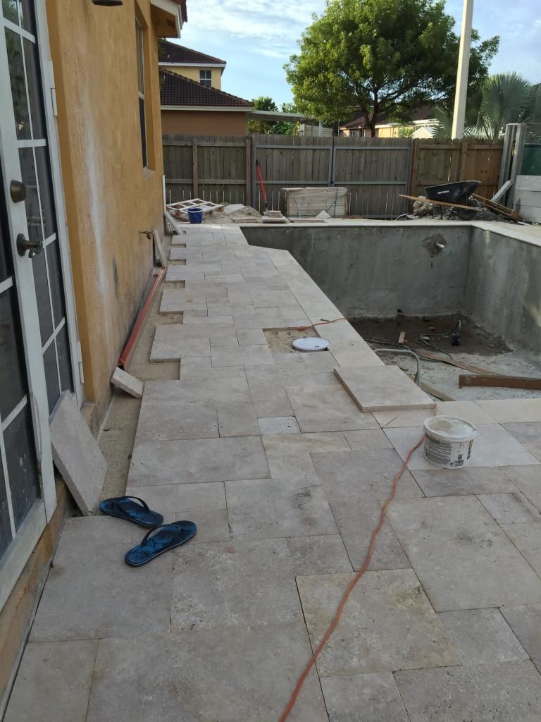

Yesterday I worked a bit on the deck after I returned from work. Look below at the progress so far. The pavers on left are out on purpose because I need to place a deck drain there. I am also trying to figure out the best way to make the cover of the skimmer be as flush as possible with the surface.

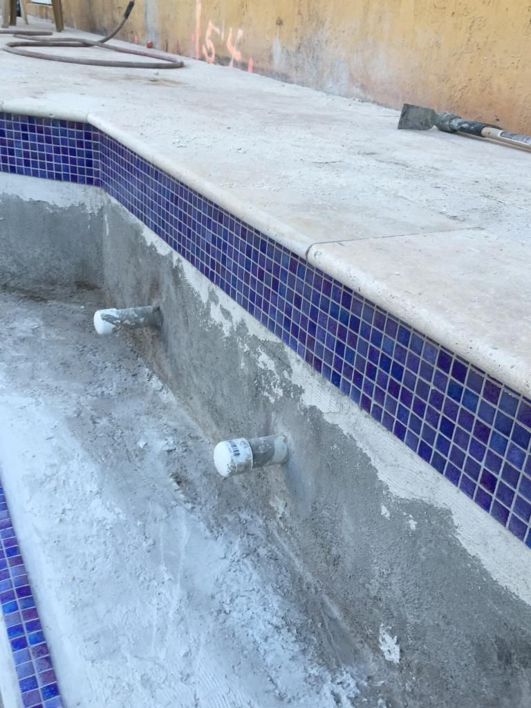

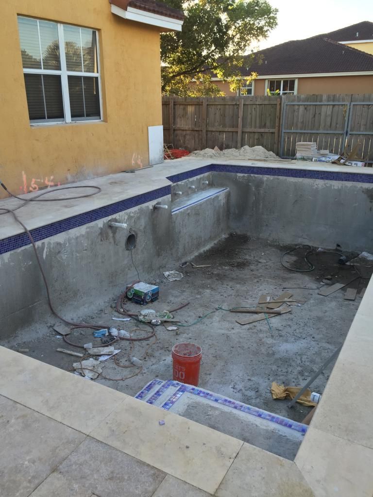

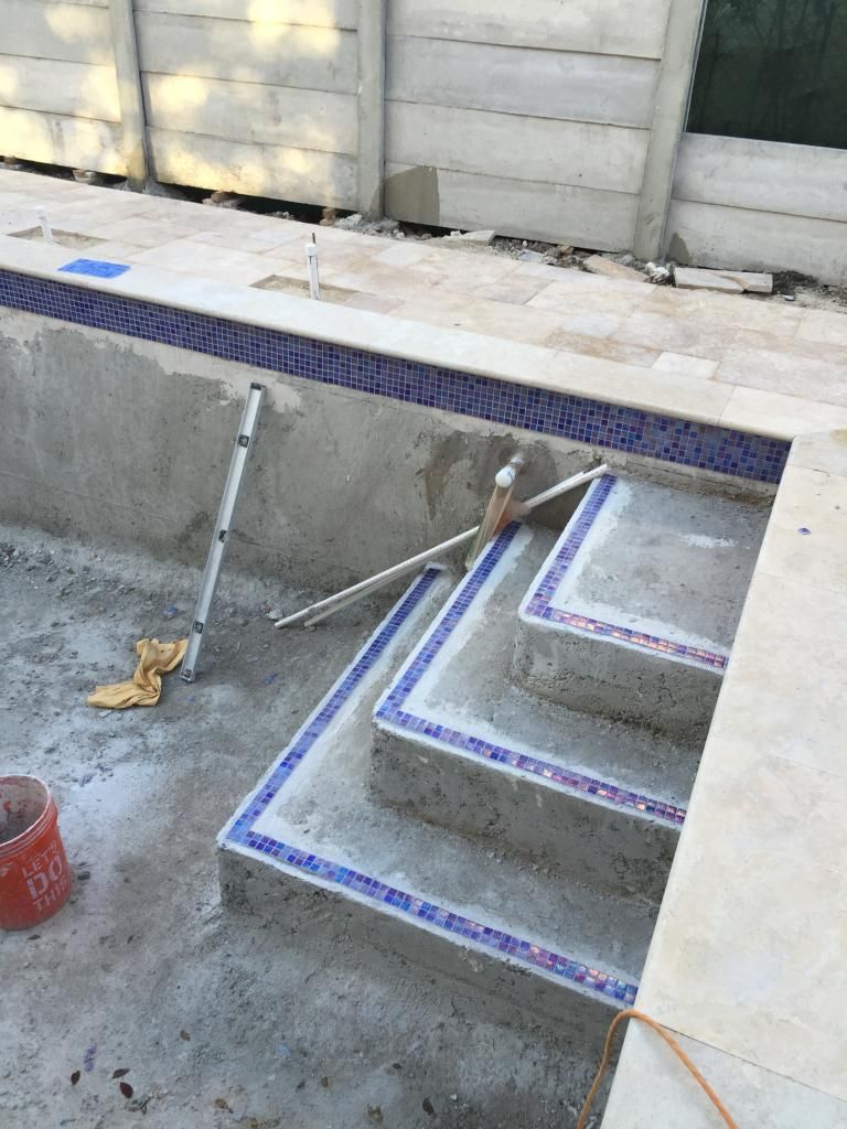

Thanks! I did the waterline tiles myself. After doing the whole travertine deck i said what the heck! Ended up spending $280 total (tiles $240 and bonding/grout was around $40). It was pretty simple to do, finished the whole thing in one day. I am now leaving on a trip and will resume pool business in late december. Remember i am building by owner so i am pacing myself because I need to be one hiring and monitoring all contractors. I should be done with the whole thing by mid january.
With all the deck and tile savings, i am on track to finishing build south of 18k...sweet.
